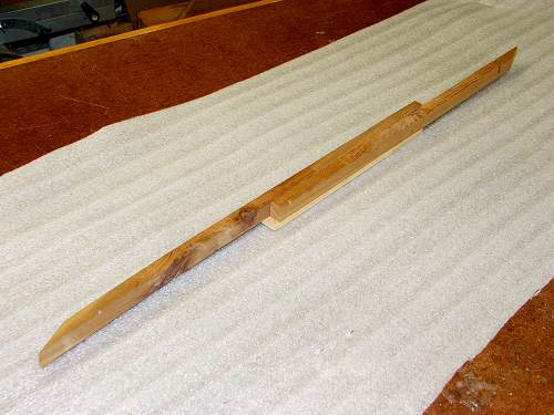

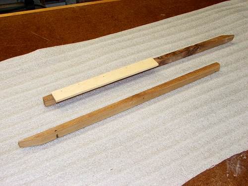

              I use pinch rods to compare diagonals to check for square. They've been used for centuries. I find them easier, faster, and more accurate than a tape measure.
              Mine are two scrap pieces ~3/4 X 1/2 with steep beveled ends and a ledge bradded to one piece. The ledge holds the two pieces parallel.
              Extend pointed ends into diagonal corners, pinch, scratch a reference mark across both pieces. Check opposite corners. Adjust case with clamps across the long diagonal until reference marks are the same for both corners.

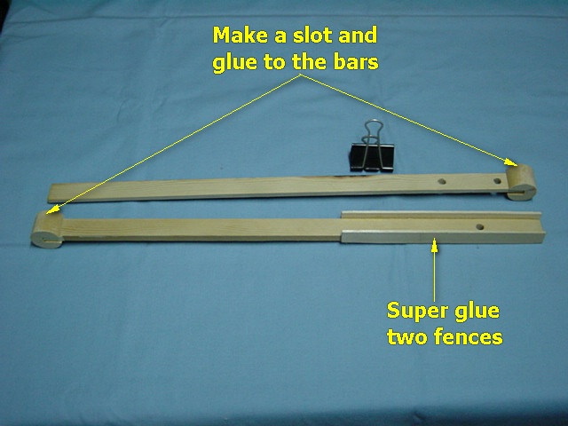

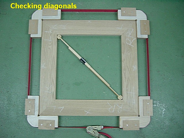

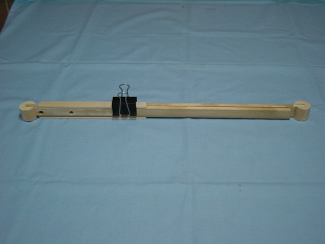

                    I was using the "pinch bars" (bar measure) but I modified the ends...
                    I got tired from cleaning the glue squeeze-out from the ends...

                      Niki:
                      I like the round ends to avoid glue in the corners.
                      Here's an idea ...
                      Make the round ends a little longer on one side. Then you can use the pinch bars for inside diagonals and for outside diagonals. Hook the outside corner in the slot in the round end.
                      We may be reinventing the wheel, but it's progress!
                      - Lonnie

                          Thank you Lonnie

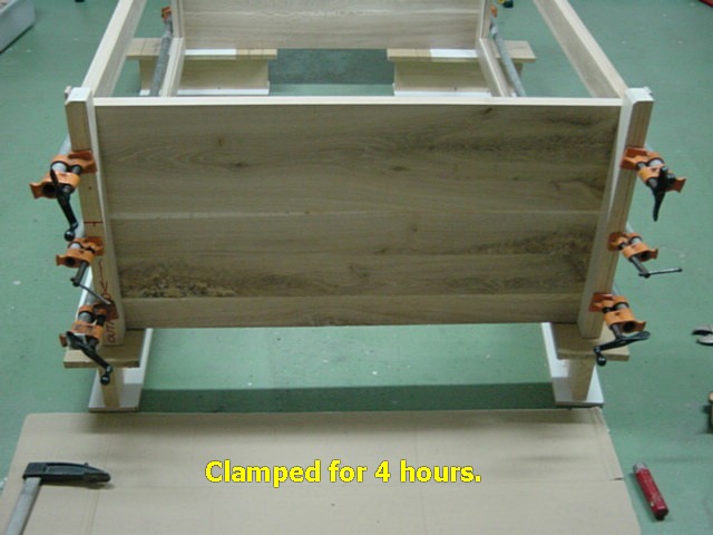

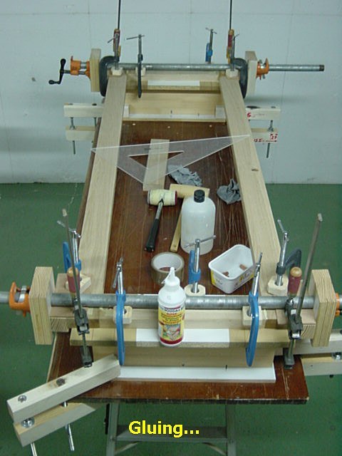

                          You idea is very good but, I never had to check outside diagonals...usually the outside of a carcass or a frame that I'm gluing is full of clamps and blocks...as in the pics below
                          Regards
                          niki

                          • ironhat
                            • 2553
                            Niki, are your rods a pair of 1 meter and the other about half of that? I guess it's not so important but I'm just curious. The rounded ends are neat as well.
                            Blessings,
                            Chiz
                              Niki
                              One of your other idea's gave me one. Those triangles you built, screw some clamp plate to them and use them to make sure the cabinet is square during assembly.
