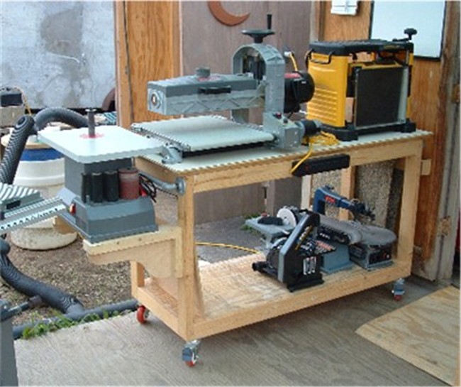

        This weighs in at 385# and I can steer it from either end. The casters are 4" wheels with steel axle bearings made by Darnell-Rose (casters.com) and have been in service over 5 years. I think I paid about $12 each for them.
Name:	spindle sander.JPG
