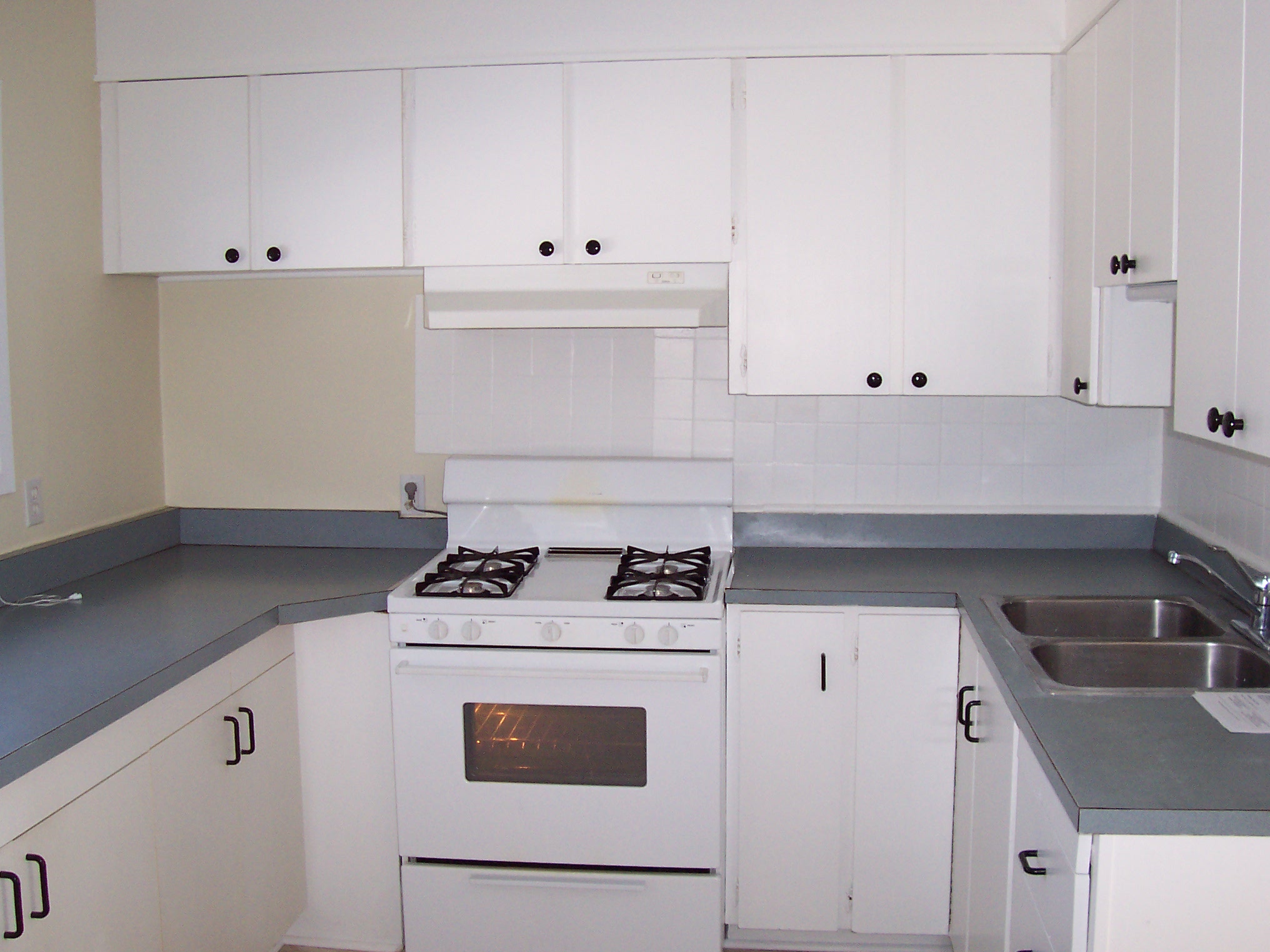

      I'm just an amateur at the woodworking and renovation thing and I did my own cabinets.
      It was not so much an issue of being a complex job, more of a very time intensive work. Basically took me a year of mostly weekends to gut the old kitchen, remove the wall between the kitchen and dining room which meant moving HVAC, plumbing and electrical wiring, re-doing the floors and building the new cabinets.
      I went for the frameless, painted "french provincial" look that seems to be so popular now.
      I'm happy with the results and most likely saved a truckload of money but I'm not sure I would do it again. Too much work!
      Here's a before picture and a couple of after ones.
