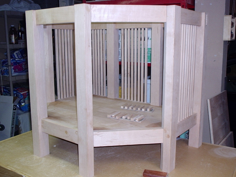

            It's two thicknesses of 3/4" plywood. The top layer is alder veneered, the bottom layer is junk. I'm veneering the underside for exactly the reasons you surmised, Bill. I'd hate for a visitor to praise the work on his way in, only to discover shoddy workmanship just prior to his removal. The top is going on this thing.
            Good suggestions for the use of tape to align the sheets. Also the veneer hammer looks effective. I'd never heard of that before, and it looks like something that can built in the shop, as Pecker suggested.
            Thanks for talking me of the ledge, guys.

              Wow, that's really coming along nicely JR! Is the rest of it alder too? It seems to have a Stickly feel to it, oak maybe? I can say my experiance lies more in people passed out on my floor than with veneering the underside of tables. So you can understand my curiosity on how it's done...
              You still got some good suggestions here though.
              I can see why you want to do that now from the picture. You sort of will be in there looking at it.
              Be sure to post pix when you've got it finished.
                All alder, Bill, for two reasons. It matches the furniture in my office, and I could get it in 12/4, which made the legs nice and stout.
                Yeah, one could reasonably expect to be going into the lower shelf area. It would be a shame to spend all this time on a project, then be dissatisfied every time I reached for a book.
                  That's one reason we build furniture, so it's just the way we want it.. It's looking good so far. You got of all of stout and a bag a chips there.
                  Maybe you had not done it yet for the photo but I didn't see a chamfer on the bottoms of the legs. You might want that. I've found it gets rid of splintering of the legs when it is moved around.
                  You should be a little easier on your house guests too. You don't want clumsy paramedics with a gurney dinging up all that nice alder furniture. My experience has been that they are very inconsiderate when removing people off of ones floor and out of the house.
                    Thanks for the advice, Bill. I have not chamfered to bottoms of the legs, but you make a very good point about splintering. I'll take a close look at that.
                    I got the laminating done last night. It was my first time doing that. It came out ok, but is not "top-shelf" quality where the seems meet. Good enough for the underside, though, as long as it doesn't de-laminate.
                    One last thing to do now, trim the top, and it's ready for stain.
