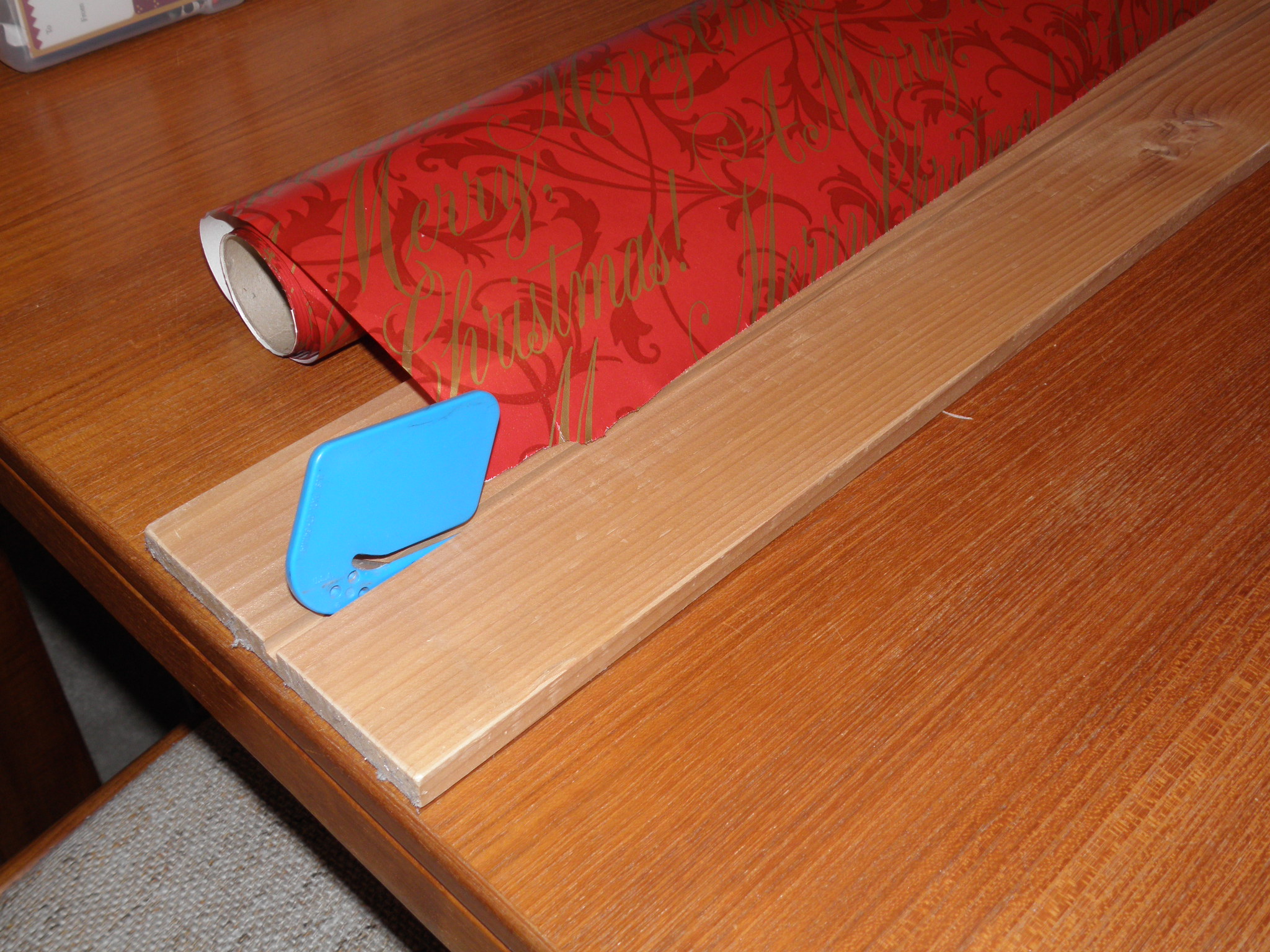

    OK, this is not a super killer project or anything, its a 10 minute project that solve a problem and I'm secretly very satisfied with it. Maybe you'll find it useful.
    Problem: You got these rolls of wrapping paper 24-36" wide and can't cut them straight.
    Solution:
    You get these inexpensive envelope openers for free with advertising, trade-shows etc. they have a slot to direct the flap/paper and at the base of the slot a small cutter to slice the paper, very safe etc. By themselves they won't cut straight, but with a straight guide slot, they'll cut straight lines.
    So the jig is to get a 36" piece of scrap lumber like 1/2 to 3/4" thick, 3-6 inches wide and cut a small dado groove down the center wide wide enough to pass the bottom of the opener (about .175") and deep enough to place the slot opening at the top of the jig (about .2" deep); basically cut and fit. You want the wood heavy enough to stay in place.
    It was two or three passes with the thin kerf blade to get it where is passed easily, no need to break out the dado blade. The slot can be pretty sloppy, 1/32th oversize is probably desireable. Like the pic below, so it will stand up and lean slightly if placed there. Rip fence microadjuster is perfect accessory to use here.
    So now I can put the tip of the opener in the slot and zip a crosscut in the wrapping paper on a perfetctly straight line without even trying.
    You just have to place a finger or two on the paper pressing it against the wood, to get the cut started with your other hand.
    Pic below:

    That's a great idea. LOML has a wrapping paper cutter that is basically a 36" piece of plastic "angle"--which has a sharpish edge on one side. All you have to do is put on the paper, hold it down and tear the paper along the edge. It works great, as I'm sure your's does.
    Of course, if I made yours, I would get shop time, and appreciation, which equals more shop time .
      • 22040
      did I mention LOML? she hasn't seen it yet. Doubt she'll appreciate it, crooked edges don't bother her but they bug the heck out of me. I've wrapped both of presents I boght this year...
        That's pretty darn clever. You could even make a more elaborate version that could hold two rolls of paper (in little trays on either side of the groove). Then, when someone is done, they could fold the entire thing up and put it away.
          Here's what I did. I took a 42" piece of 1x4 and nailed an equal length of an old fine-toothed bandsaw blade to it, so that the toothed edge just protrudes past the edge of the board (like on a roll of tin foil). Now I just lay it on top of the rolled-out paper, and rip whatever length I need.
