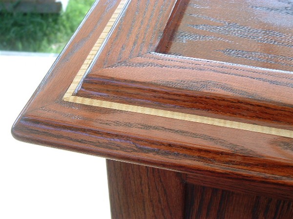

        I did the final shaping on the edge of this by hand with a file, scraper and sanding.

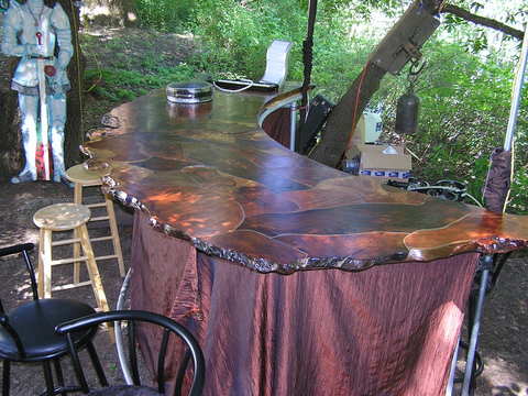

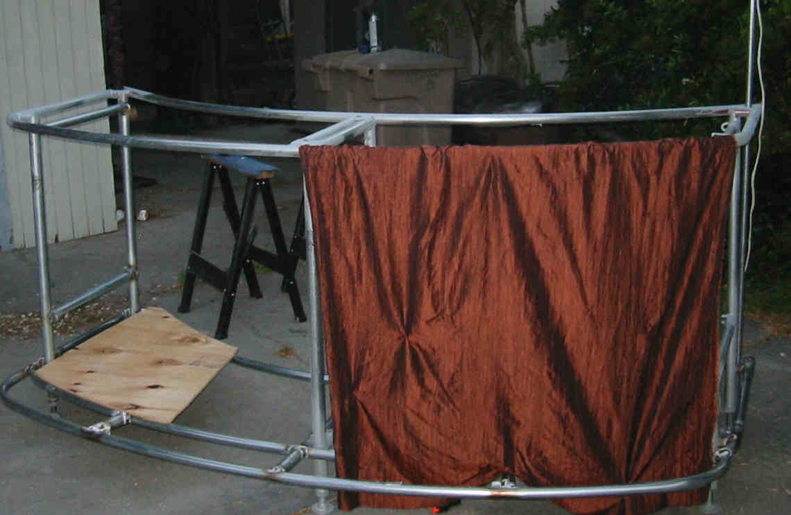

          Our bar
          Couple of friends built this bar.
          I've never posted pics before
          We're a group of home brewers with a camping problem.
