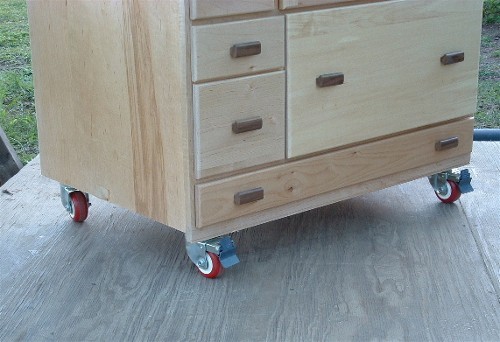

            Mine is on swivel casters with the front 2 being dual locking. Never had a problem because of the casters.
Name:	Router station Casters.jpg
              Yes, casters are OK, but definitely get good ones with solid locks. You don't want the thing shifting even a little bit in the middle of an expensive piece of wood. As for height, if people were all the same height, we still couldn't agree on which was the best. It's more important that you be able to work comfortably, and from a stable stance, so use a height that you know is comfortable for you. That's the beauty of building your own.
