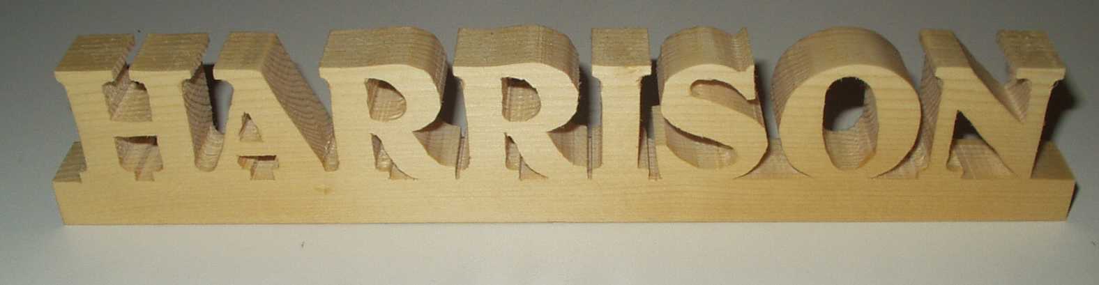

    I made a few more of these name placques. An aggaravating issue is how to get the tung-oil finish into the insides between the letters. I tried Q-tips before but that was a disaster - while I filed and sanded some the insides were still somewhat rough and left q-tip lint all over. Any suggestions?
      http://www.bt3central.com/showthread...light=harrison
      Shake and Bake?
      Put item in plastic bag with tung oil -- shake and rotate well... :-)
      Remove excess with cloth -- lint free of course.

        I'm with Rod, I just finished some shelf supports that I'll be posting up later this week, all fluer de li, and I used glue brushes to get into the scroll work, they worked very well.

          Another option would be cheap brushes from the hobby dept. Bristles would be softer.
            Or you could place the entire piece in a large enough tray and "spoon" a finish into the cut-outs. The extra would drip back down into the pan and could be reused.
            After you're done, hold the unit above the tray a minute or two so it can drip, then use small pieces of rag through the openings to buff/remove extra (think shoe shining).

              Try putting the tung oil in a turkey baster and squeezing it in.

                Re: the rough edges: I bought some little strips of sandpaper that attached to my scroll saw that allowed me to sand the inside edges. I bought them at a show, so I don't remember the source.
