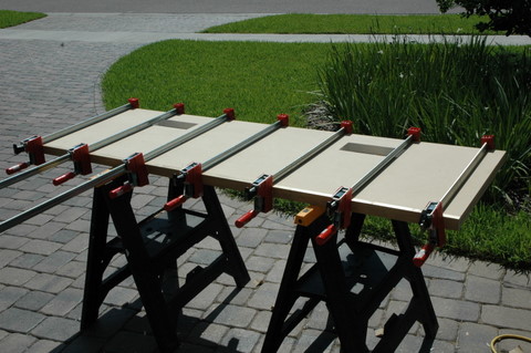

      For attaching the MDF and holding it in place while the glue dries, confirmat screws could be another possibility. I ordered some from McFeely's a while ago and they work well. Not terribly cheap, but good. I got them to fix a problem where I made a case that the shelves were slightly different lengths, and it solved the problem well. Not the solution I wanted, but it worked.

        Thanks Jim. I am going to go with an IR repeater behind the doors. I looked at the Confirmat, and then ran into the Spax screws at HD locally before I got a chance to order them. The Spax are MDF & hardwood self-tapping and don't split in MDF. They turned out really well.

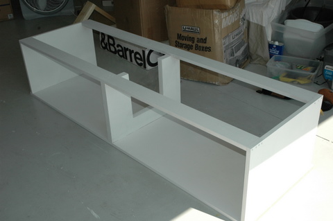

        Here is the progress so far (see pictures). The base unit is built and in place - no doors yet, and I'm going to do the base cap tonight probably. For the doors I was thinking of just a flat recessed panel with an applied molding (poplar for the rail & stiles & 1/4 birch ply for the panel?? Should I just rabbet the back of the r&s's, (I dont need to groove it as you would a raised panel, do I?).

                  gary, did you paint the carcass and then cut the dadoos? did you spray it or paint it on?
                  omar

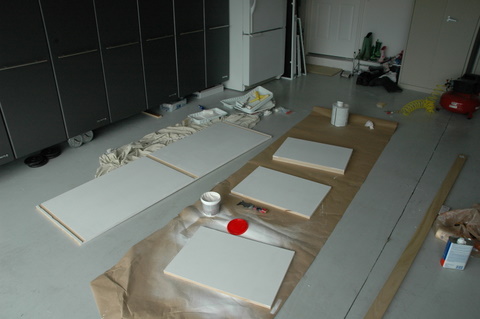

                    I did all cuts first, then primed the pieces, then assembled, then painted. I ended up painting it with a fine roller, which did not yield great results. I tried painting it initially with a Porter-Cable HVLP gun I bought, but as those wiser than I in this forum pointed out (after I explained the blotchy results I was getting), I didn't have enough compressor (CFM). I have since went out and bought an Earlex HVLP spray system, and am certain I'll have better results on the doors (which it doesnt look like I'll get to them this weekend after all)
                    Question for anyone who may know - with the base carcass installed now in my family room, would it be a bad idea to sand down the (somewhat bumpy) finish I got on the exposed pieces, then repaint with the HVLP? I'm not sure about doing that in the house (even with careful masking)??
