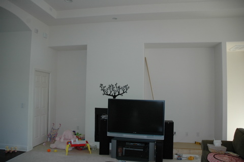

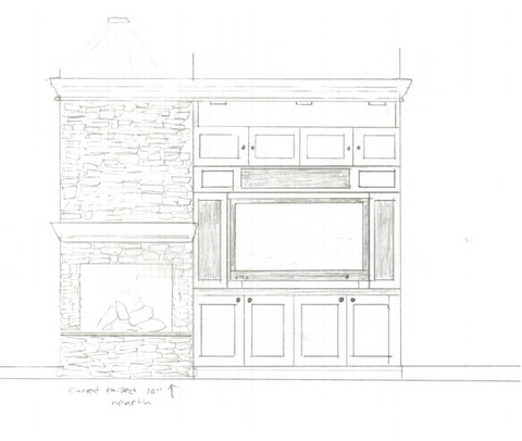

    So, I'm finally getting started on my family room built-in project. This is new to me. I have a recessed area right next to fireplace (will have stone and a raised hearth when I'm done) in the family room that will house all of my audio/video components in base cabinets. On the top of the base cabs will be my 55" Sony HD rear-projection set, and a speaker on each side with a frame and speaker mesh covering it. On top of that (still somewhat undetermined as far as design), will be my center channel speaker, etc. The measurement of the recessed area is 110"x76.5"x24". See photos (as you can see, my daughter has taken over the house), and my "renderings".
    The cabinets I was going to make from MDF, and they will be painted white. I've begun by building a 2x6 (slightly ripped down) torsion box base. The MDF base for the cabinets is cut to size, and I was going to dado for the left, right and center supports (was thinking of putting two pieces of MDF in the center to support the cup hinges).
    I've never done a project like this, so I certainly have questions. Let me throw a couple out to you guys:
    1. See any flaws so far with the plan?
    2. Would you use hardwood banded MDF for the top, or should I use plywood?
    3. Heat is a concern with the receiver, etc...so I wanted to vent, and install some small low voltage cooling fans in the cabinet - any ideas
    4. I bought a Porter Cable HVLP PSH1, and tried/tested it out for the first time with a Zinnser oil-based primer. I'm getting spatter, and looks like I may need to use a different nozzle set here?? Should I just roll it??
    5. I was going to use the oil based primer, then a Porter white semi-gloss latex (to match basesboards)...anything over that? Should I not use latex?

    Rear projection TVs generate a lot of heat, you'll need that space actively vntilated. You need an intake near bottom and an exhaust near top.
    Intake can be accomplished by venting the toekick. I would pretty much remove the toekick board and cover it with speaker mesh to match the speakers. Remember - being an intake, it will attract dust, so you'll want to install a filter behind it, an make mesh removable so filter can be cleaned. Depending on what is behind that wall, intake grille can instead be installed near the floor on the other side instead - making it to look 'in place' on that wall, and again, providing filtering.
    For exhaust, several options. It looks like you want an open shelf at the top. You can make this shelf about 6" less deep than the recess and vent through the shelf back. You can put in several vents, also covered by speaker mesh, to align with the lights. Install fans behind those vents.
    Take a look at http://www.directron.com/casefans.html
    http://www.directron.com/a2330.html looks like a good fan choice - very quiet. You might also want to consider a controller like http://www.directron.com/doc5.html

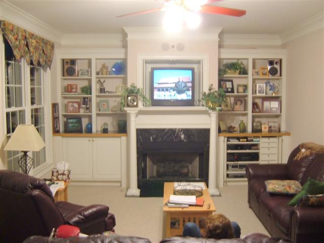

              I have cabinets on either side of my fireplace with the TV over top of the fireplace (an unvented gas unit). The base cabinet on the right has the receiver, CD/DVD player, cassette, DVD/VCR recorder plus some drawers for storage. I did not have sufficient storage so I built another end table to hold DVD/CDs/VHS tapes. The top of my cabinets is marble tile which matches the fireplace surround. It is more durable than wood would be. You need a double layer of plywood, maybe two layers of MDF would work if the supports underneith are close enough together. It can't flex. The front edge is oak biscuited to the wood underlayment. It's easier than you may think but you need to borrow, rent, or own a wet saw to cut marble or granite tile. My marble is black and I just butted it together and pushed a little unsanded grout into the small crack.
              I did not vent the cabinet where the sterio stuff is but I have to leave the doors open when using it so I can use the remote. I made the doors so they go back into the cabinet so it looks OK with them open. That seems to keep the equipment adequately cool - I have had no problems in 5+ years of use.

                Your components seem to be stashed in the unit below the TV, meaning their airflow is so-so, but TV currently has a very large dissipation area, so you don't currently notice much heat coming from it. But if you put that TV into a recess, and close off the gaps all around it, you will have an oven. Even for LCDs, a setup like that is not recommended - an a rear projection, with its high-powered lamp, is gonna cook. If behind that wall is a closet, I'd think twice before using it for exhaust/intake - unless it's a real large closet, and there won't be clothes obstructing the vents.
                For the fans/controller I linked, you'll need a 12V source - generally, these things are designed to plug into a PC power supply. But any 12V adapter will do as long as it can provide 4-5amps.
                  Your project doesn't represent a big problem. As for the construction, I would build it as a slide in. The base cabinet can be made with two ends and a center divider. You won't need any fancy joinery if you are using MDF. The three standing pieces are attached to the floor of the cabinet. The toe kick could be made as a loose piece, but not as involved as you drew. It will sit under the floor all the way around with just a front and back, and two sides. You might just gusset the corners to keep it relatively square.
                  On top of the ends and the center (which will all be the same height) run cross rails front and back across the three pieces and glue and screw them to the verticals. They should be 3/4" plywood or solid wood. Lay them flat and make them about 2 1/2" to 3" each. Make the top from 3/4" MDF and put a 3/4" buildup under the front and back and middle of the top underside to coincide with the cross rails.
                  Hot air rises all on its own. You would be surprised how much air gets passed overlay doors on euro hinges, with door bumpers. You could mount fans inside the base sections exhausting upward and have corresponding ducts to the top shelf. You don't have to move a lot of air, as long as there is some transfer. As for the TV itself, if you have a small gap around it for circulation, and some behind it, that may be sufficient for cooling. You will need some room to get it in and get it out.
                  As for paint, You could use a semi-gloss acrylic, from the primer to the finish. Or, an oil base. In either case, allow a long time for the coats to cure, even if they may feel dry to the touch.
