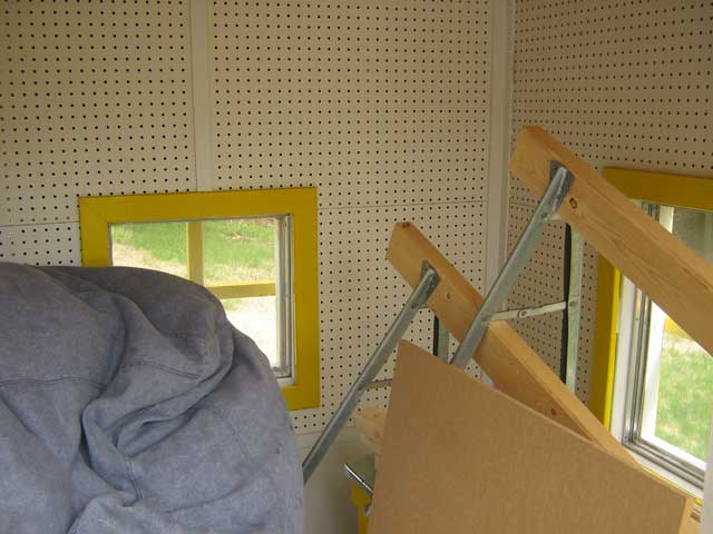

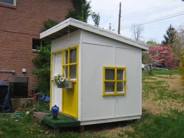

                      On my kids playhouse I used 1/4 white perf'd hardboard on the walls and ceiling. Lets the framing breathe and give plenty of places to hang stuff on.
                      Mind you it seems to get used more as a hold all for crap than the kids playing in it.
                            Of all the replies, I like this idea the best. It accomplishes several things mentioned in other posts, it quick and easy, plus the white hardboard will help reflect light inside and keep it from being so dark.

                              The hardboard peg board is a good idea for safety/looks. Plus we know the true purpose is tool storage when the kids out grow it. Put the pegboard in now and you don't have to have that discussion with SheBeast 5 years from now.
