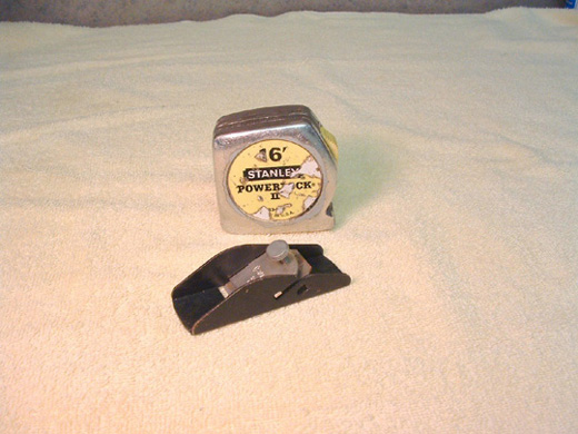

            You would make a line where the dish will end, and where the center is. You can use a convex spokeshave, convex drawknife, or a mini handplane, like the one pictured (Stanley 12-101).
