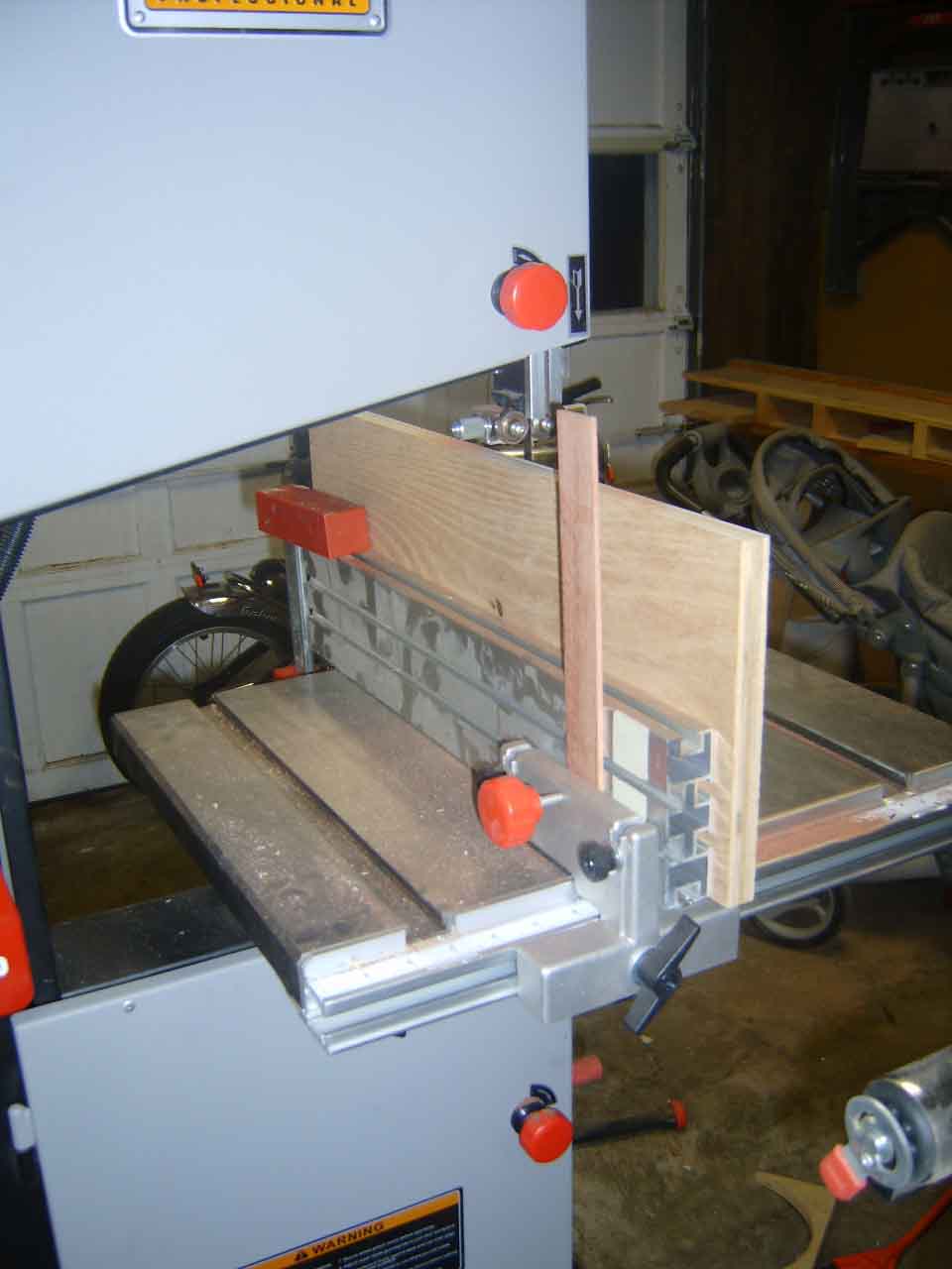

            here it is
            Well it was much harder to resaw an eight inch board than I thought it would be.I guess I should consider myself lucky to have got three pieces. It was pretty slow going with a 1/2" blade. Maybe I shouldnt have used my 1/2" blade. The more I tensioned it the more difficult it was to keep it tracking. So I went as tight as I could while keeping it centered on the wheel. I made a beefed up fence for this too. I replaced the fence with the miter gauge fence from my table saw and slapped some plywood up there. The piece of wood sticking up is a shim to get it square. With it being so long and not the original fence the little red knob wouldnt do anything without it.

              Hey, nice bandsaw. I've done a couple of 8" resaws, they are slow going, but if you take your time, it'll come out fine. You also noticed that it's a good idea to clamp the back of the fence. Overall I think you have a pretty good setup, the only thing that might have helped would be tall featherboards.

                Yeah I noticed as soon as I put the plywood on that there was a little flex towards the back so I clamped it.. I should probably sand the plywood and slap some poly on it or maybe I will pick up some UHMW strips at woodcraft tomorrow. Never tried it but they are supposed to be pretty slick.
