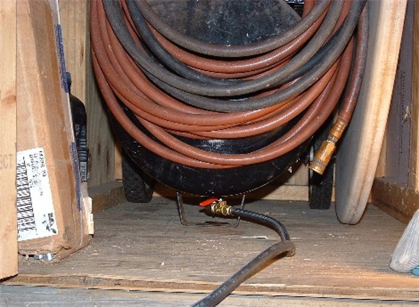

              I hang my air hoses and Oxy/acetylene hoses, welder cables, heavy extension cords, booster cables and the like on metal garden hose hangers. They're cheap and can hold a lot of weight. My shops are plumbed for air line, so I don't use rubber hose all that often unless I need to reach outside. Inside I use those nylon hoses that look like a spring.
                In my case, storage is easy. One 50' hose is connected to the compressor. I coil that one and the water filter with a 10' hose on the handle. An extra 50' hose hangs on the other door.
Name:	Compressor drain hose.JPG
                  I have seen a homemade wooden version of a reel, and just a board with a lip board attached, like a water hose reel. That should allow you to raid the scrap bin, and spend no $$$$.

                    • onedash
                      • Mar 2005
                      • 1013
                      • Craftsman 22124
                      [ATTACH]3010[/ATTACH]
                      I have my water filter immediately after the pressure regulator. It never fills up and barely gets any moisture at all. Is it because of the location?
                      I like the valve and hose on the drain. Been meaning to do that one of these days. I did replace the screw open valve which made it much better but it still shoots rusty water all over when I open it.
