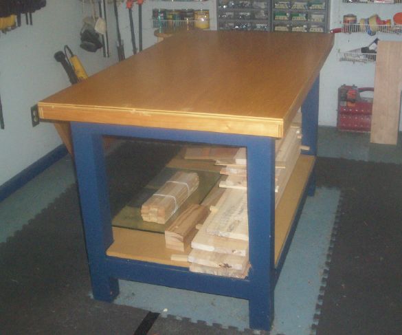

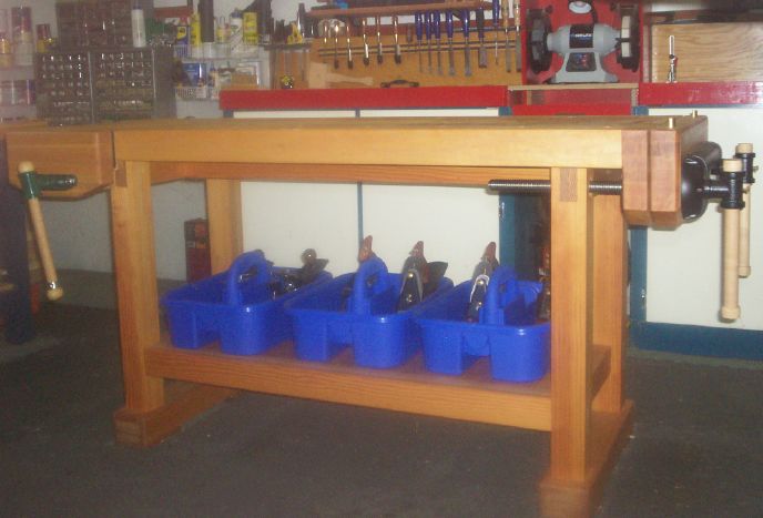

                            I usually pick up framing lumber at HD. The utility stud (2 x 4) racks you see is usually spruce or fir (not douglas fir) and normally light. If you can't find enough straight studs in that utility rack, you could consider the wider southern yellow pine in 2 x 6, 2 x 8, 2 x10 and 2 x 12. If you have rip capability, you can take them to any size you want. Always get the kiln dryed and not a bad idea to let it stabalize in your shop after you get it home as someone mentioned.
                            The habitat idea is a great idea also. I love to re-cycle old lumber and create from others throw aways. You can make some heavy duty work tables from any of the lumber that the guys have mentioned. I glue up 2 x 4's and make a lot of shop tables for others in the summer when the humidity is high here in Atlanta.
                            Below is a pic of an assembly table base made from 2 x 4's. Also my current work-bench that I made from old Douglas Fir rafter beams that came from a civil war ware-house being torn down. I had ripped it up and decided to laminate it back together to build my work-bench base with what I had laying around the wood-rack. You are only limited by your imagination. Good luck!
                            SARGE..g-47
