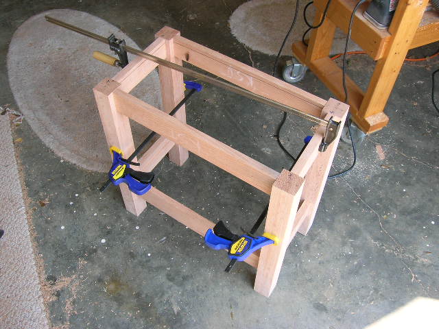

    Got to the point in my mission end tables (3 of them) project where I got to use my mortiser again. The 1/4" bit went in like butter, a world of difference from the 1/2" I used on the leg mortises. This time around it was for the spindles in the end panels of the table. Once these are done on the other two tables, I'll be ready to start assembly.
    Had one dryfit of the base parts and things seem to be coming together ok.

    Those really look like nice and solid joints, Ken!

          Someone once said "I just love it when a plan comes together". Those joints look like your job was made easy. I'm so used to doing M&T joints the old fashioned way. I've learned to make perfect markings, layout parts to be machined in a way they don't get mixed up and take enough time to fit all matching parts. Maybe one day when I'm rich and infamous, I'll buy one of those contraptions.
            Looks great!

                Nice work Ken - I've been following your lead since I bought the same tool a short while after you. I also started with samples using the 1/2" chisel - more effort than I expected. (I just saw a mortising hint at Wood magazine - they said to drill a hole on a DP smaller than the chisels bit dia. for your first cut - seems to make sense.)
