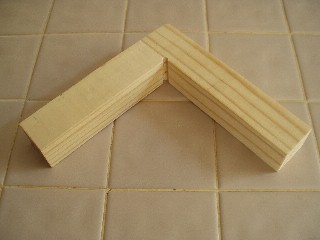

    I made a few ELLs of my own for not much bucks out of 8" long 2x2 stock squared and planed and joined carefully.
