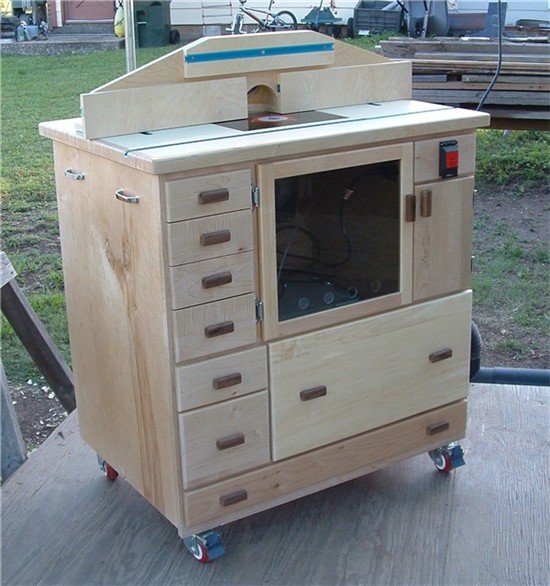

Mine is similar in size but I incorporated a router lift using a design from American Woodworker and also some ideas from other router tables I liked. I used Norm's idea for bit storage (but I used planned 2x4 scraps rather than multiple layers of plywood) and drawer arrangement. My fence has small pipe clamps like a design I saw in FWW. I really like the lift but I wish I had located the router a bit closer to the front of the router table and forgot about miter guage slots. Not worth fixing.
The BT3100 with a dado set plus a cordless drill and some hole saws was about all I used.

In the picture, mine has a Rosseau plate with a Hitachi M12V. The top has since been reworked to hold a Woodpecker lift.Don, aka Pappy,

Great improvement over the undertable height adjustment. The instructions say not to remove the springs from the M12V but I am thinking about removing the one from the post away from the lift mechanism and let that side slide free. When the router is lifted high, it seems to want to rack to that side a little.Originally posted by just4funsiesHow do you like the 'pecker lift, Pappy? Mine's on the way... I love the M12V. It's more than a tool, it's MACHINERY.
