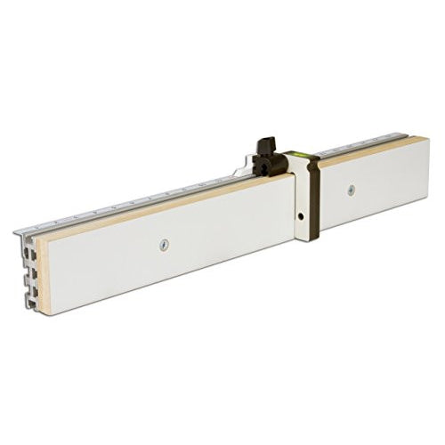

        Loving my wood river. It's perfect for cutting pen blanks. I found a second use.... it's also great for aligning the rip fence.
        I drop the blade, extend the gauge, then make sure it kisses the fence for the entire length.
        If you like spending money, woodpeckers just came out with a pretty nice alignment kit.

          I have the Incra version of that. The Woodpeckers looks faster to use on the TS, but the Incra might be more useful on other tools where this one seems to be for the TS only. The Incra is two pieces of track bar at a 90, one slides into the slot. You can change that configuration to use it on other tools.
          Yesterday I needed high precision for one build, and was so happy to have the Incra and Woodpecker's ultra-precise and REPEATABLE tools.
