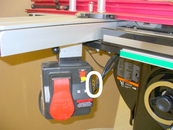

                      A key operated switch on the right side of the switch assembly is used to defeat the safety feature, you simply turn it and you have defeated the safety feature of the saw. The key switch is spring-loaded and returns back to its off position after you release it. And indeed, once you have started the saw and turned it off again, the saw is back in the safety mode. So providing you don't keep the saw running you can only make one cut at a time in the bypass mode.
                      I tried several times to upload a picture of the switch assembly, but the upload fails every time.
                      Cheers!
                      Tim
                      PS Just found out that image hosting on the forum is not available yet.
                      Edited, 10/14/2012 Added picture

                            I edited my post by adding a picture to my earlier post in this thread, but the thread does not show again when you log in again after posting. (hope this makes sense)
                            So let me add the image in this separate post and see if the thread will show up.
                            By the way the only way you can confirm you posted the image is by checking "preview post". And how do you add more narrative after an image?
