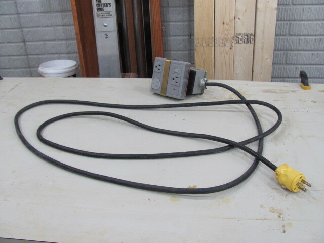

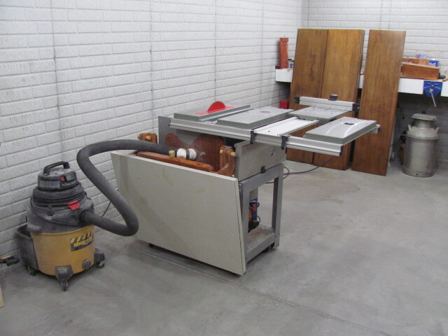

      Welcome. I'm not sure why the Ryobi shopvac is required. I've had my BT3000 connected to three different ShopVac machines since 1993. The first was just a regular cheapo machine that I already had, didn't even have a drain port. When it finally died, I replaced it with an industrial 12 gal. ShopVac rated at 195 cfm with a steel tub. It used to build a huge static charge that would jump a 2" spark after a few minutes use. A couple of years ago, I replaced that one with a 16 gal. ShopVac also with 195 cfm. These vacuums have been THE shop dust collection machines for all of my power tools over the years. I have two CleanStream filters for the vac. That way one can be in use while the other one dries fully from cleaning. I use the vac. with a Craftsman tool triggered switch permanently wired to a 12 ga. extension cord to turn the vac. on when the connected tool is started. It runs the vac. for 15 seconds after tool shutoff to clear the attached hose. I use three different diameter hoses to connect to all of my power tools. I have a 1", a 1 1/2", and 2 1/2" hoses that connect to the ShopVac.
      Click image for larger version  Name:	IMG_1655.JPG Views:	0 Size:	73.5 KB ID:	847517
      Click image for larger version  Name:	Tool Triggered Extension Cord.JPG Views:	0 Size:	64.5 KB ID:	847518
