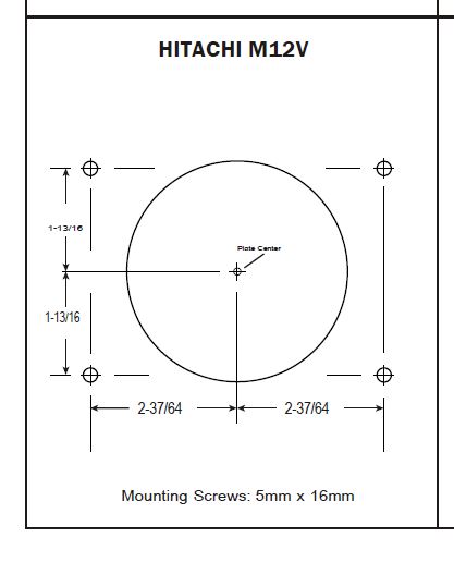

        what router model do you have, I have a list somewhere of all the bolt circle patterns for major routers.
        I think I also have a drawing of the hole locations for the router mtg plate.

          Thanks for the help. I'm sorry it took a couple days to check back in. My router is a Hitachi.
            I asked for the model; you didn't say, I presume it was a M12V. Click image for larger version
Name:	hitachi pattern.JPG

              It is an MV12. Thank you
