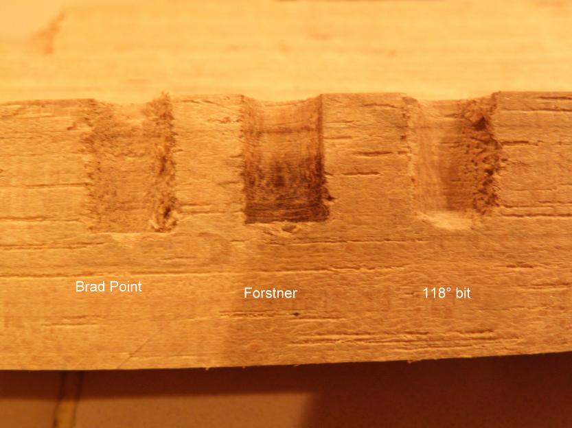

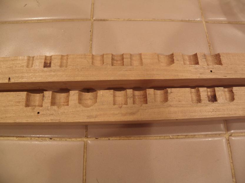

                last nite i drilled 1/4 3/8 and 1/2 holes with regular drill bit, forstner and brad point. And then sectioned it on the table saw.
                the forstner was pretty much dead flat across the bottom except for the center hole and maybe just a nick at the outer edge.
                The brad point was close to but not dead flat - the spurs on the outer edge cut a little deeper and there was a slight rise across the entire bottom towards the center, which if course had the hole in it, too.
                post a picture later.

                    the following pictures
                    each show from L to R Brad point, Forstner, and 118° drill bit
                    The first picture is 1/2", the next is 3/8" and the last is 1/4"
                    The fourth picture is the whole thing.
                    Drill press at 1900 RPM.
                    you can see the forstner is dead flat except for the center spike, the brad point has a spur on the outside and a slight rise across the bottom.
                    The brad point were a Delta set I got many years ago, I think it may well depend on the grind, I now realize should have tried different brad point sets, I have at least three.
