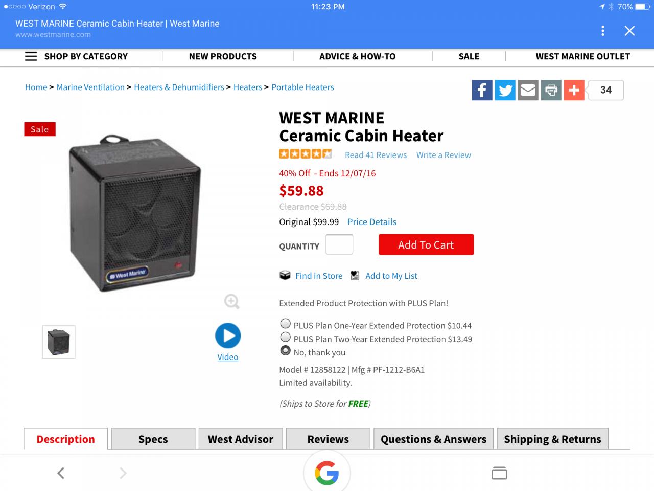

    I don't much like the heaters with visible elements. i purchased a couple of these ceramic cube space heaters to heat my houseboat with. It had very little to none insulation plus it being on the water made it extremely cold in the winter. The ceramic heaters were so effective I seldom used both. I think these were the most expensive ceramic heaters, but I though I needed "marine" since it was for a boat. I believe the $25-$30 ceramics would be just fine.
    capncarl
    • woodturner

          The blower was what I really liked about the ceramic heater. They are small but boy they put out the heat. We set he heater on the galley counter, pointed it toward the stern and it would heat the whole boat
