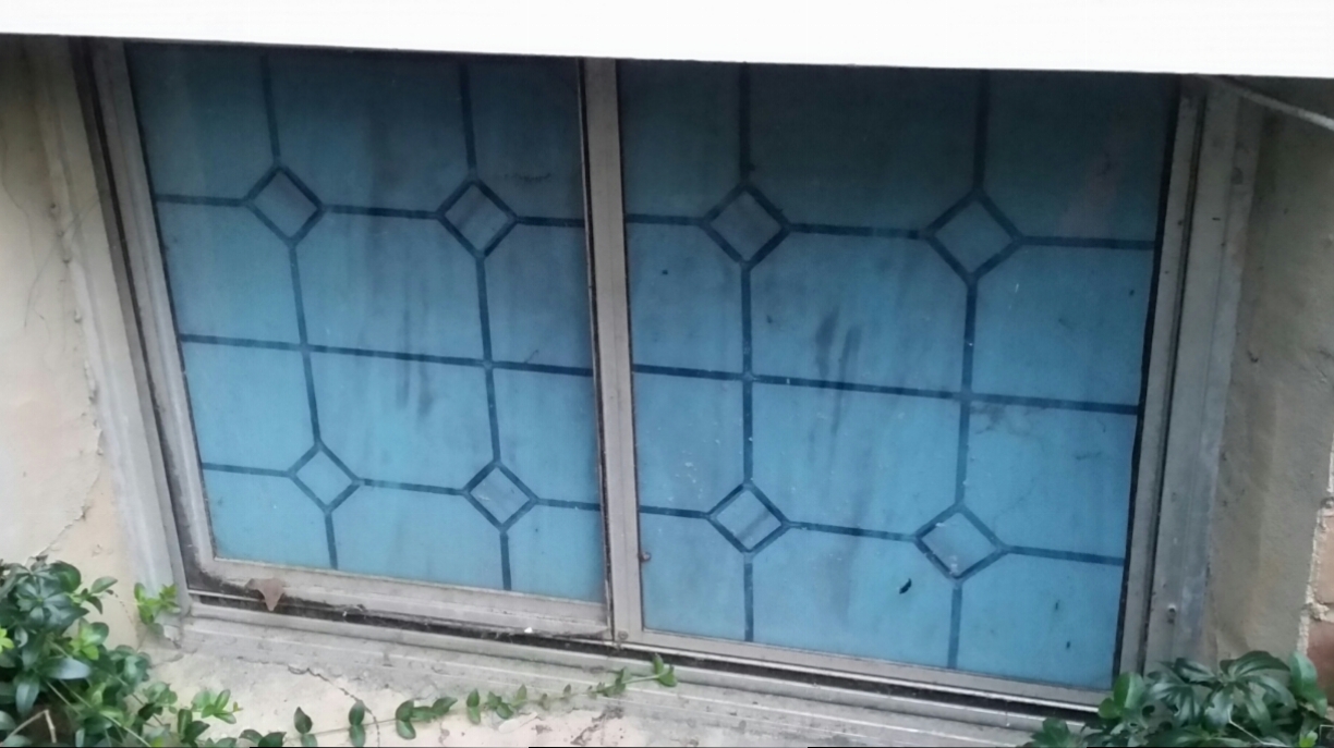

    Wife was complaining she couldn't air out the basement because there was no bug screen. Then she reminded me that years ago that an exterminator removed the screen to free a bird that got trapped in our furnace. Then she says he had to cut the screen out, he didn't pop out the frame. I don't know why it's take 2+ years for me to realize this.
    Anyway, the screen doesn't seem to be part of a separate frame that pops out. It looks like it was integral to the window unit. The window slides open left to right as you see it. I think it's aluminum.
    Any ideas on how to get a new screen in there?

    It should actually lift up and pull out. The whole screen frame. It may not do that, but it would be a first. Never seen one that cannot be removed. They usually have springs or spring steel on top that keeps them pushed down.
      I'll look again. So it must pull out towards the outside, right?

        I think that the screw that is in the lower bottom center frame keeps the screen frame in. Remove it, there may be a mate to it in the top. The screen frame should slide into the void in the center frame and then come out.
        The screen frame might be corroded in and difficult to remove. This small of a frame may be fairly easy to install new screen fabric in place.

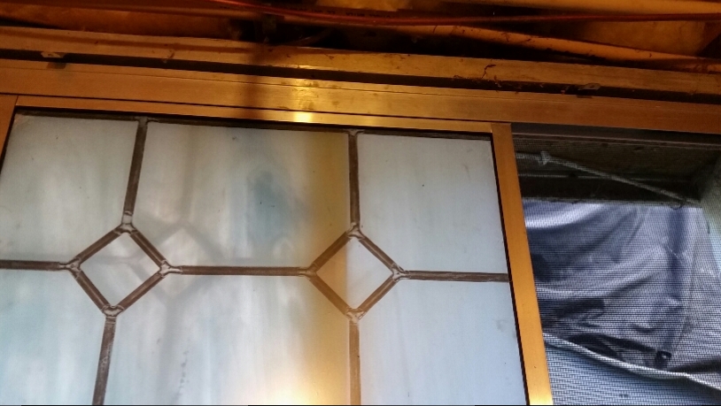

          I'm going to make reciting Occam's Razor part of my morning routine. So I got the screen spline out from the outside and I'm on my hands and knees trying to remove those rusted screws (square drive), when I'm like "let me go inside and look again". There are two little spring tabs on the top of the window which I didn't pay any mind before because why would anyone make it so easy? Anyway, I gently pull down and back on the tabs and the whole slider comes on. After laughing at myself for a little bit, I installed the new screen--really wished I hadn't misplaced that spline tool--and the window is back in business.
          I'm sure you guys would have figured it out had I started with the inside pic first.

            So... the screws did not hold the screen in? Most I've worked on used this method.
              There's one on the bottom (visible) and one on the top hidden by the overhang. I could only remove the top one and I had just sprayed the bottom one with WD40. The screws may have held in the frame but it was definitely easier to remove the whole window with those 2 spring clips.
