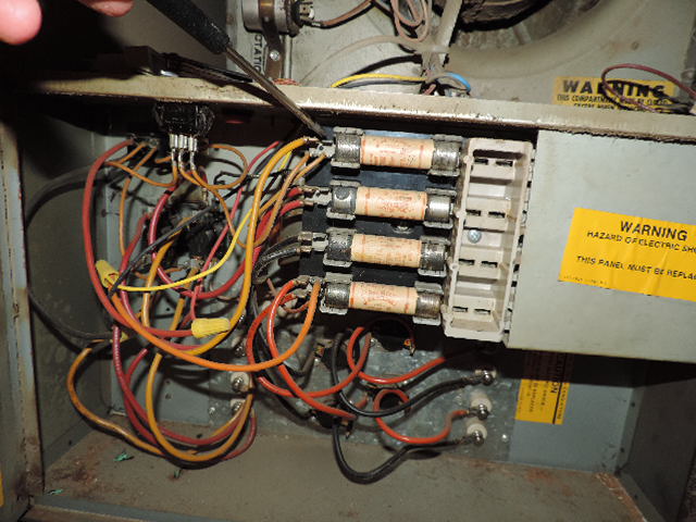

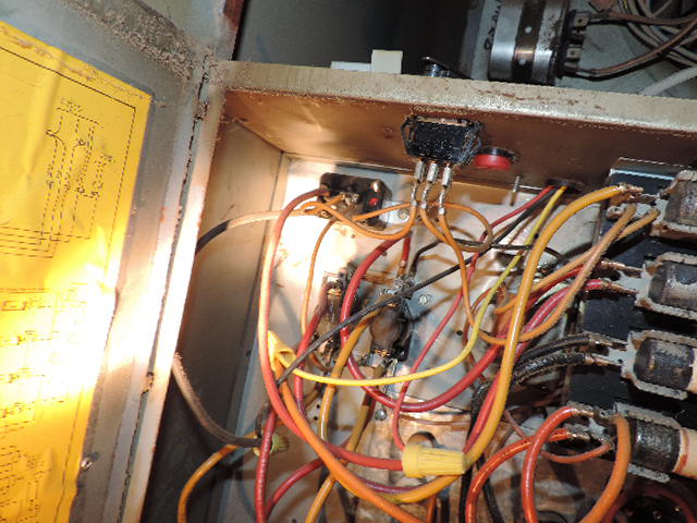

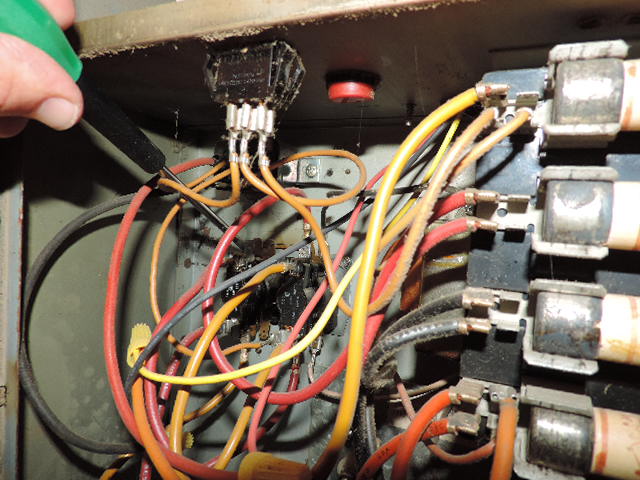

          A wire shorted out. Now I need to figure out if the wire over heated before it shorted or after. I hope it was just a case of vibration rubbing a hole in the insulation which caused it to short out. Still I'm nervious that it never tripped a breaker nor did it burn the cartridge fuse that was supplying power to it.
          Shows on end of where wire attached
          Where it attached on the other end. This end was shorted out.
          In this view you can see what is above the burnt wire. I think it rubbed on the terminals upper left.
