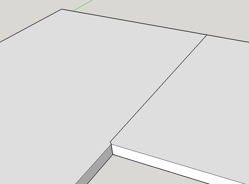

            So the question. The IKEA tops have a small bevel on all the edges. The major complaint I've read is that crud gets stuck in the valley where the two countertops meet. To avoid this, I was thinking about doing the following joint. IIRC, I've seen Norm do this on a smaller scale when doing window muttons. On the longer board, I would rip off the bevel and cut a 45deg miter to meet up with the newly mitered edge (or the other way around). On the mating piece I'd cut off the end bevel and cut the corresponding 45.

            Sounds simple enough, but how would you accomplish this or is there another solution to get rid of that valley without resorting to wood putty? I also don't want to completely rip off the front edges because I want the full counter depth.

              I can't think of a way that avoids handwork entirely. A track saw could cut most of the way to the miter but not the entire way. A handsaw could finish it but I'd want to leave wood for a shoulder plane. One end of my Stanley comes off so you can go to a corner like this. You could get closer to the miter with a router on the track. I have the DeWalt attachment for the track but I haven't tried it yet. If you used a router, you could get within a fraction of an inch to be cleaned up with a chisel or plane.
                The Dewalt track saw is on its way as well as the router guide. I will have to practice this cut on scrap first. Yeah, I can't think of way to do this without handtools. I'm not worried about that, but just wish it wasn't towards the show side. Even with the blade at full depth, there's still going to be a scallop which will have to be cut back. I will probably use a guide to cut that little miter. I have a little 45deg block I made for my chisel that I'll use to make it perfect--I hope.
                  I would either practice on scrap or leave the counter a little long so I could cut off a failed attempt and still have enough counter.
