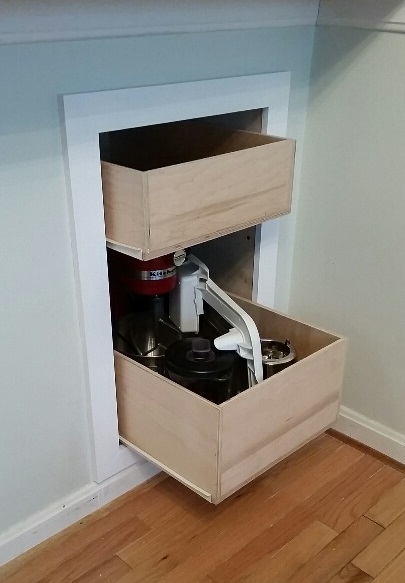

      Last week I nailed on the trim and painted it. The trim was the trickiest part. My slip-in box sits proud of the wall in spots so after milling up the trim stock, I made a 1/2" x 1/2" groove in the back of each piece to slip over the box. The pieces are also mitered together but my slip-in box opening was square so all the miters closed up nicely once I got the pieces cut to the right lengths.
      The drawer boxes are simply 1/2" ply glued and stapled together. The bottom is also glued and stapled on. The staples blend in and aren't really noticeable at all. I used up some extra epoxy drawer slides since this cabinet isn't going to be used frequently. The door is built and just needs to be painted and hung but I'm calling this one done. Actually a relatively simple project and as you can see, we've already started using it.
      Paul
