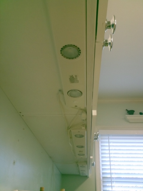

        I was discussing this with the wife this morning and all she had to say was, "Well, it would be nice..." so after using some cable anchors and zip ties, it's done. You can see the switch about half way down the front. From the front, it's all hidden behind the face frame. No cable mods were needed.
        I have one more to install and that one needs to have the chord cut short and the new plug end added, but first I've got to expand a 2 gang box to a triple. Wish I had done that when I first put that double gang in.

            Boy was I wrong! The main kitchen switch is across the room and these new lights are much closer. For a quick kitchen snack (not helping), I will just flick on the new lights. I located the chord lamp switch behind the junction of two cabinet stiles so it is very easy to locate. Now I ALWAYS leave all the lights on and just switch them all on/off with the chord switch. I was finding I was still fumbling around for the switch on the light.
