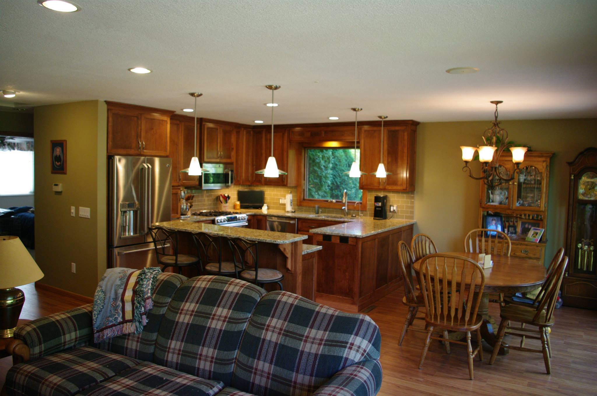

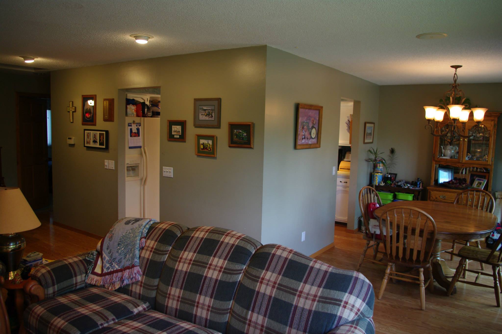

        My advice - knock down that wall. You'll be amazed how much more open and modern the room will look with all that space opened up.
        We used to have an L-shaped living/dining room with the kitchen walled off. Last year we did a major remodel, tearing out both of those walls, putting in a 2-level island bar and peninsula, and opening the space up to a large open rectangular "great room". Attached are a couple before and after pics, and if you'd like more, including many "in-progress" photos, you can click this link (public, no need to be a FB member): https://www.facebook.com/media/set/?...1&l=d84bc5c792

          Wow Tim! What a project - the before/after gives a great idea of the ROI!
