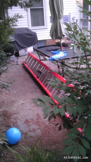

                  I've got a few inquiries out on CL now. It's predominantly fiberglass ones for sale. On the Werner site, the 300lb rated fiberglass ones are supposedly 3.5lbs more than the aluminum ones. 59.5lbs vs 56lbs. It's going to be heavy any way you look at it. Hopefully the closest guy gets back to me. It'll be fun driving 30+ miles with this thing on my roof rack.

                    Getting the ladder home was a non-event. $160. Other than some cosmetic scratches, it looks brand new. From the CL pic, it was hanging in his garage. New is $300 but other sellers with the same ladders for less were flaky. CL sellers need some simple lessons in marketing like know your product or actually contact interested buyers
                    Now the fun begins...
                    Requisite poor cell phone pic
