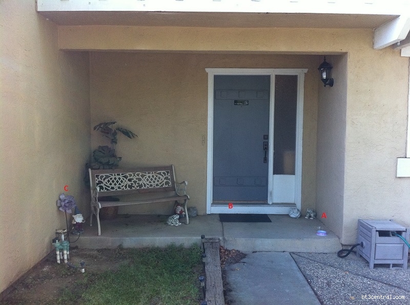

    I want to enclose my entry way and eventually have new entry enclosure/porch.
    I talked to my towns building inspector and he said I needed to tie in the ventilation to the existing structure. I was trying to visualize how that would work but I don't understand the "why" behind it to fully grasp it.
    My current porch consists of a 7-8" slab, the walls around the slap appear to be built upon 4x6's (my first floor rests on 4x6's about 45" OC).
    It seems to me that getting the new floor I would add to vent to the old crawl space would not only affect the integrity of the existing structure just a little but it would be a major PITA to cut a hole in the 4x6.
    Can anyone offer some insight into this?
    Below are pictures with the labels A, B, C, which are to show what is what and where and to hopefully help explain exactly what I need to do.
    The picture with the numbers are to represent possible placements of vents or holes to the old crawl space.

            And just so I'm clear about what I'm asking; the inspector was talking about ventilation under the new floor that will be built that apparently needs to mix with the crawl space under the house,

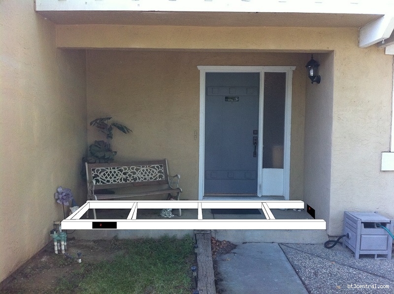

              The "why" is that the space needs to be vented so condensation and other moisture sources don't cause rot. What you show in your drawing should be fine, provided you provide a path through the new joists to the vent in the side wall.
              I would consider extending the new floor framing system three or four inches beyond the existing porch, leaving a 1" air gap between the end cross joist and the concrete porch. This gap could be filled with ridge vent material to keep out bugs but allow air flow. I think that would look a little better.

                  I was just doing some more thinking and I realized an overhang won't work. The existing porch slab will essentially be extended out to form the new porch and there won't be a way to over hang the joist for ventilation purposes.
                  Can I vent by drilling ~1/2"-1" holes through the existing joists?
                  Since the existing joists are 4x6's I can use 2x4's for the new joists which should give me about an 1-1/2" gap that would allow full ventilation into the existing crawl space, provided that several 1" holes would be sufficient enough.

                    That should be fine - the key principle is that the input area of the vents should equal or exceed the output area of the vents. If the vent into the side wall is 4" x 6", for example, that is 24 sq in, so you need 24 sq in of 1" holes, or 31 holes (each hole is 0.78 sq in, (.5)^2*pi).

                        I've been doing some more thinking and I just realized the 4x6's under "A" and "B" aren't load bearing! I can cut out all of "B" and half of "A" if I needed to, although "A" does have a wall above it that I had planned on keeping.
                        So the question then becomes; how do I build the floor framing so that it is tied into the existing structure and at the same time allows me to vent the newly framed floor into the old crawl space?
                        I was originally going to screw a 2x6 to all three sides A, B, and C but that would mean my possible areas for venting would be blocked.
                        Any suggestions?

                          It looks like a PITA but I think if I take out A and just extend two 4x6's out I'll be good. One 4x6 will be an extension of the 4x6 currently connected to A, the other will be one that goes across the front of the house/porch. I will then screw a 2x6 to B.
                          I'm not sure what C looks like but I may need to attach a 2x6 to the wall and hang the 4x6's off of that.
                          Does anyone see any issues with this plan? Do they sell 4x6's?
