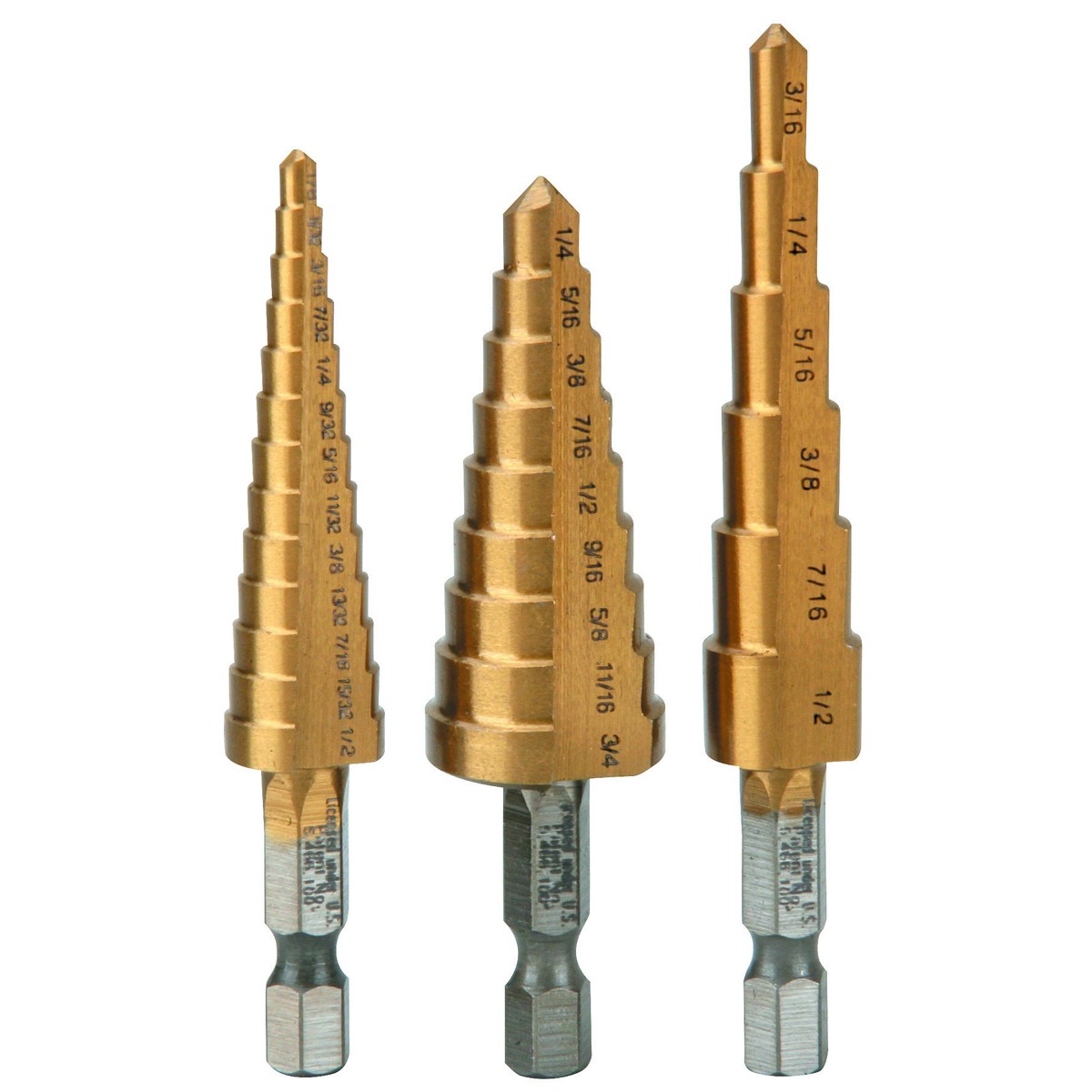

                      • 3791
                      I would suggest using a unibit, sometimes called a step bit. I always start off drilling a pilot hole in stainless, and always use Tap Magic for coolant/lubricant when machining and drilling stainless. Nothing to it and you will find plenty of uses for the unibits around the shop. HF sells a 3 pack for about $10 that will get you by, not as good as quality bits that sell for $30 each but they will work. Don't put much pressure on it when drilling, and drill slow.
