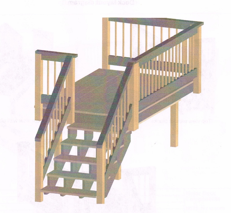

    Drawings were done with Lowe's Deck Designer and did not give me the flexibility to incorporate changes to the framework that I want. The program's cost estimate is $1050 - $1104 but I think I can bring it in for far less.
    Basic Design. I plan to move the outside posts to the corners, use 4x4x8' so they will also become part of the rails. The inside posts will be positioned as close to the side of the pool as practical and still avoid any contact form the flex of the sides. The program would not allow the steps to be drawn less than 3' but they will be 2' 6" so she can easily hold on to both rail caps.
Name:	Deck Design (800x739).jpg

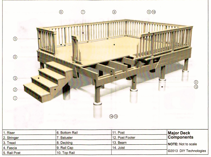

    The second pic is a parts diagram that comes up in the printout and is included to make sure the same terminology is used by everyone.
Name:	CCI09182013_0000 - Copy (800x595).jpg

    Questions.
    Would using one of these allow me to safely use untreated 4x4 for the posts?
    http://www.lowes.com/pd_15897-71255-...are&facetInfo=
    http://www.lowes.com/ProductDisplay?...llow&cId=PDIO1
    Any graceful way to end joint treated and nontreated 4x4's so the posts above the deck would match the material in the rails and still provide treated contact at the ground. Possibly a tenon in the treated part to a mortise in the non treated positioned so the beam would screw to both sides of the joint to add strength? The same idea could be applied to the stair stringers.
    Any other cost cutting ideas or caveats I need to watch for?

      Don, I know you are trying to keep the costs down, but I would think long and hard before using untreated wood instead of treated for the handrails and pieces not in contact iwth the ground. I don't think using treated would cost all that much more and it would certainly last a lot longer and, I believe, would also be safer for your wife if she is relying on the handrails. You do have to wait a while before painting or staining treated lumber to be sure it is dry enough to take the paint well. Otherwise, you will soon be repainting it.
      64sedan_at_gmail.com
        You've got a great start on this project, Pappy.
        I like the use of Trex for the decking - especially when found at a discount! You should have a lot less trouble keeping it in good shape down the road. It does have different requirements as to joist spacing, as noted by mineengineer, so play close attention to that.
        I would think about using an opaque stain or paint. That way you won't have any trouble matching its effect on different materials. It also means that when you have to fill cracks or splits there won't be any trouble covering the repair. I'd also think about having some sort of skirt around the base of the deck, mitigating the problem of difference in materials, but also masking any construction details with the post bases or whatever. You could also gain some storage space for pool tools, chemicals, etc.
        Most deck designs have beams attached to the top of posts, then rail posts attached to the rim joists. Attaching the beams to the sides of the posts requires special considerations, about which I can't offer advice. If you want to go this route, and you want to use the two-materials approach to posts, a scarf joint is the proper connection between the two materials. A simple half-lap scarf would be plenty good enough.
        I recommend using PT for the posts, no matter which connector you choose. In fact, I'd recommend using the 1" offset bracket along with PT. Posts do rot at the bottom, so you should do everyting you can to mitigate this. Then again, maybe my recent experiences are coloring my thinking.
        Here's the deal with post connectors. If you use treated wood you can attach directly to concrete. If you use untreated wood you need a connector with a 1" standoff. In either case an H-bracket is the proper connector.
        Check out the Simpson Strong-Tie Deck Center site for lots of good information on connectors for this application. These guys have done a great job of getting their products incorporated into building regulations, so following their advice is a good idea.
        Here's a little pdf from my town's site giving some good ideas on what one needs to do for a conformant design.
        The balusters need to be no more than 4" apart. Getting them spaced evenly is a problem. Here is a video with a really nifty trick from Tom Silva on doing this.
        One final thought. Make sure the pool equipment is oriented such that you have good access to everything. You may eventually have to repair leaks, motor, pump, etc. And of course the filter needs cleaning periodically.

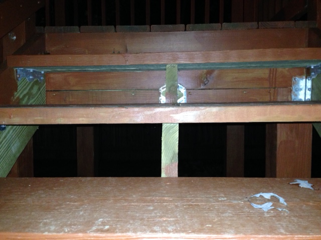

                  I don't have experience with that particular hanger, but I built my deck over the summer and spent a bunch of time fretting over the best way to mount the stringers to the rim joist, which hangers to use, etc. I went a slightly different route. (Just offering an option that may be helpful to you.)
                  If you've already cut all 3 stringers, disregard the following. For this, the outside stringers are cut differently than typical stringers (but simpler). Sturdy angle brackets are used to mount the outside stringers to the rim joist, and "stringer bracket(s)" are used to mount inside stringers.
                  I prefer to mount a 2x8 below the rim joist to mount the inside stringer brackets to (could also mount outside concealed stringer brackets [like what you referenced] to this 2x10 so that the top step could be placed a step lower than the deck surface (so the top step doesn't jut out proud of the rim joist, even with the deck surface, not that there's anything wrong with it.
                  I've attached a pic, that may help explain. (Not a great pic - taken with my phone, in the dark. Not quite done staining the deck, so excuse the unstained under stair area.)
                  Good luck!
