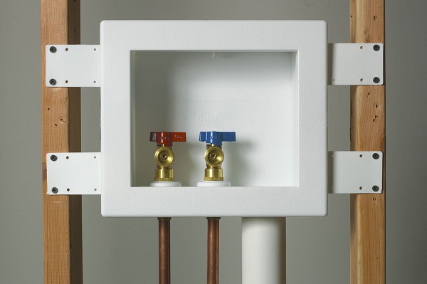

    I cannot figure out how the washer box is supposed to connect to my existing plumbing.
    I'm using this box:
    http://www.oatey.com/Plumber/Shared/...let+Boxes.html
    I thought I would just screw it on to the current plumbing but that doesn't make sense since it wouldn't be able to lock into place correctly on the washer box.
    It looks like the copper simply slides into the threaded pipe but then how does it prevent leaks?

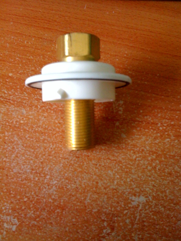

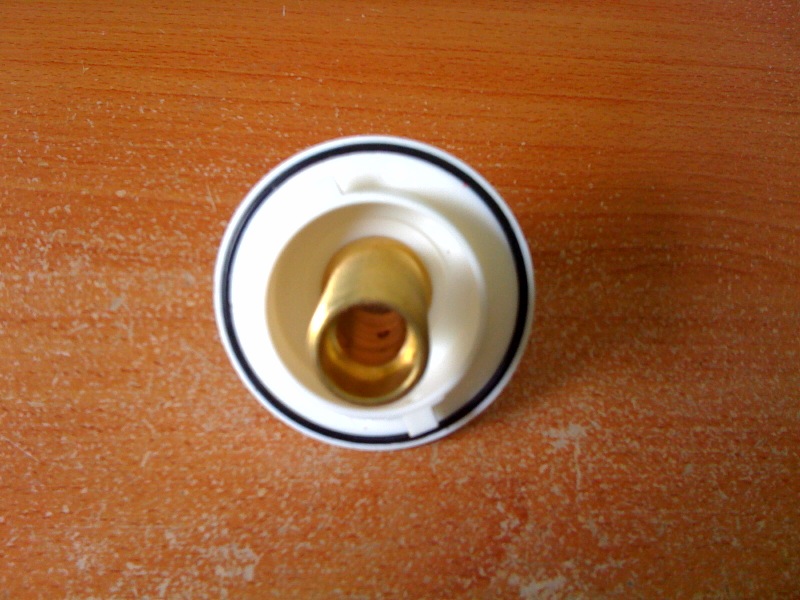

          The plastic piece in the 2nd and 3rd pic doesn't come off (at least I can't get it off).
          I have the female fitting on their now but, unless I measure it perfectly, when I go to screw the male piece into the female piece it wont allow me to lock the plastic housing into the washer box housing and may not fit properly.
          Soldering the pipe to the fitting seemed logical but the way the part was designed doesn't make soldering too easy (I have about 1/2" from the bottom of the fitting until I hit plastic).
