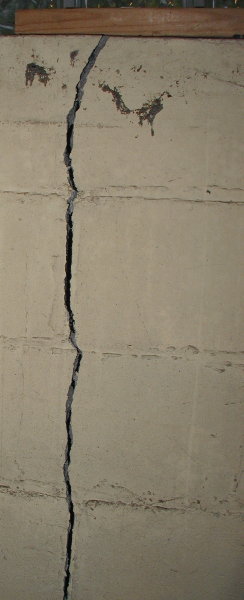

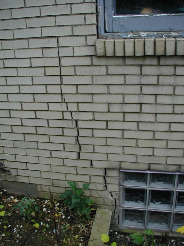

    I have a basement crack that appears to indicate a broken footer - the corner has dropped. It's looking like piering will be required. Quotes range from $1500 to $35,000 to repair
    Has anyone had this kind of work done? I would appreciate any thoughts, comments or ideas. This is the first (and hopefully last) time I've had this kind of problem and work to do.
    Thanks.
    Whats the cause? Is the soil expansive? Drainage/slope issues? Failed sump? Has the crack expanded? Pictures please.
        The exact cause is unknown at this point, but it could be a failed drain tile causing soil to erode under the footer or roots from a bush that was in the area and removed.
        We do have some clay soil, and the crack is showing some movement seasonally, suggestion soil moisture is part of the issue.
        I have attached a couple of picture showing the crack inside and out.

          in your case do they have to dig down to get below the basement?
          Yes, they would excavate something in the range of 20' down each side of the corner to the footer, then install the piers and backfill. Depth is in the range of four to six feet to the footer. Most of the contractors are suggesting six piers.
            Yikes! As you mentioned. the vegetation that was there is a very likely cause of the drain failing. As a future preventative, you may want to remove anything larger than seasonal flowers for a 2' band around your house, obviously replace the drain sock/tube. Will your insurance cover any of the cost to repair? Why are the quotes so different in range?
