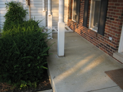

    Two summers ago, I had posted about replacing the bottoms of my front porch posts.
    More than a few things came up and the project got put off until now.
    Here's the porch, minus the railings and spindles that were all rotted.

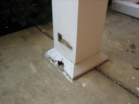

    Here's what the bottom of the post looked like before:

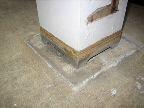

    I sawzalled out the rotted piece (which was finish nailed up into the post and spike nailed down into the concrete) and slid/hammered the new piece into place.
    I replaced with an aluminum plinth from the BORG.

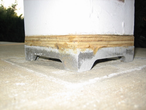

    The treated plywood spacer is screwed/glued to the aluminum plinth and has a hole cut into the center to allow airflow.

    Around the bottom of the post will be moulding at some point. Maybe PVC, or cedar or treated- don't know yet.
    My concern is that originally, the wood bottoms were nailed/spiked into the cement to hold them steady. Right now, with the one that I have done, there is nothing holding it in place. And I have NO idea how I should go about doing so.... Brackets? Long tapcons?
    Am I just looking to stop lateral movement- or do I need to be concerned about lift as well?

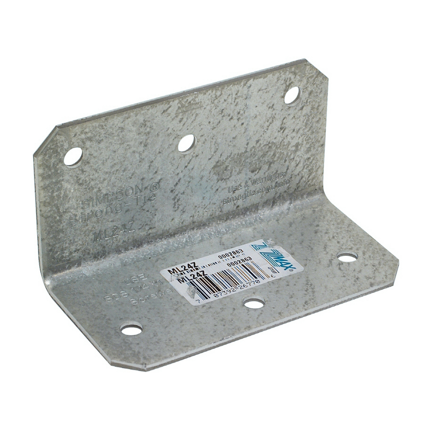

            So the only ideas I'd come up with are long tapcons drilled diagonally from say 6" up the post or so, or using something like these simpson strong-ties.

            The catch is that the size of the shoe moulding would have to be big, and that they are made for wood-to-wood- so don't know if that would cause any issues.
            If there's something more elegant- I'm completely missing it...
              You could install a fairly thick base moulding around the post to the deck. It could have a decorative profile around the top edge, like a cove. Make it about 6" - 8" high. Toe screw (with countersunk Tapcons ) the base to the deck, and screw into the post. That will stop lateral movement, and help mitigate lift.

                  The problem with toe screws is you also have to drill through the metal plinth, or at least I do. Doable, but would require a couple different drill bits. My other thought was take the right angle bracket, cut down the bottom so it is only 3/4" or so wide, drill new holes in it and screw that to the post and to the porch. Then wrap everything with PVC trim that will never rot.

                    Oh, dread the thought of needing a couple of different drill bits. The base moulding could be a double up (stepped), which gives the thickness which affords the toe screw to have sufficient bracing, and nowhere near the metal plinth. Drilling a deep countersunk hole at a steep angle works very well.

                      If you can find tapcons of the appropriate length with a head that will fit in a pocket hole, then a Kreg jig shoud solve this problem. Drill through the aluminum with a HSS bit, and then into the concrete using the pocket hole as a guide. Wrap the bottom of your post in a shoe molding to cover the pocket holes.

                          Working around the existing conditions to solve a problem is not as easy as planning from the start and having an empty space to begin with. In that situation, brackets of some type are the best way.
                          This situation is an afterthought. Many home repairs are in this category. I've used an add on plinth moulding to do this type of repair on many occasions. Of course all wood parts on all surfaces should be sealed and painted, and any spaces should be caulked.
                          It's worthwhile to buy the correct tooling to do the job. On some Tapcon packaging, the bit is included. I wouldn't find alternative methods that were inferior just because I didn't want to go buy a drill bit.
                          This plinth example may be a little out of scale for my taste, but it shows how using a buildup can accomplish the task. In this setup, the drilling into the concrete doesn't have to be at a severe angle. The add-on moulding is both decorative and functional as a fastening technique.
