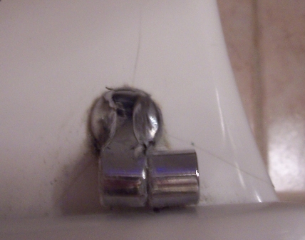

    All,
    Yesterday my wife told me we had to replace the seat on one of our toilets since my three year old son's "bad aim" had rusted out the hinge and it had broken off. As I was taking off the old one, I noticed that one side had three cracks eminating from the through-hole used to mount the seat. Looking at the picture, you can see the cracks at about the 1, 4, and 7 O-clock positions. None of them seem to go all the way to critical parts of the bowl assembly, but I know that cracks are one of those things that can only get worse, especially with the seat going up and down and people sitting on it. My question is, do you think this really needs to get replaced? Even though the bowl is only a little more then 2 years old, it is not carried anymore, so I would be looking at about $120 to replace both the bowl and tank with an equivalent model. I think I know what the answer to this will be, but thought I would try to get a couple opinions first to see if there is any hope...

    You could try to leach in some thin-bodied CA glue into the cracks, but I think I'd replace the whole thing. The new ones really save water (although, if only two years old, the busted one is probably a low-water model already)...

        My suggestion is to replace it. If the bowl cracks wide open it won't be a pleasant sight. Furthermore, you should make him pay for it. Take it out of his allowance or something.

                  If it were mine I wouldn't replace it but would keep an eye on it. It's possible that the crack is not in the porcelain itself, but in the glaze. You see that sort of thing on glazed coffee cups a lot...
                  The worst that could happen is that that chunk will come off. It doesn't look to be that the whole bowl will break off or anything like that, so if that happens, then you can replace it...
                  Just my opinion as a cheapskate
                  By the way, it's possible the damage was caused by someone overtorquing the lid screws, not by the banging of the seat...

                    I'm sorta with Tfischer on all his points. If the crack won't result in a water leak and collateral damage if it lets go completely then maybe a watch and wait is in order.

                      " By the way, it's possible the damage was caused by someone overtorquing the lid screws, not by the banging of the seat..."
                      I agree. I did not notice them until later, so I'm wondering if that is the case or if it was caused by me trying to free the stuck bolt. That would not surprise me - I'm the king of the job that ends up taking 5x as long and costing 10x as much

                        This is a job for that epoxy they sell on tv. You could rebuild the entire corner if it broke off.
                          IDK, unless your certain of the extent of those cracks, I wouldnt risk it. If the bowl should crack you could have a 5 gallon a minute leak. Imagine coming home after work to find that kind of mess? What do you think the price tag to fix it will be then? My 2 cents.

                              I agree with the lets-wait-and-see position since the cracks are confined to the seat hinge area.
                              If you decide to repair the hairline cracks, check out this website for ideas:
                              http://www.deabath.com/Hightank/Toil...porcrepair.htm
