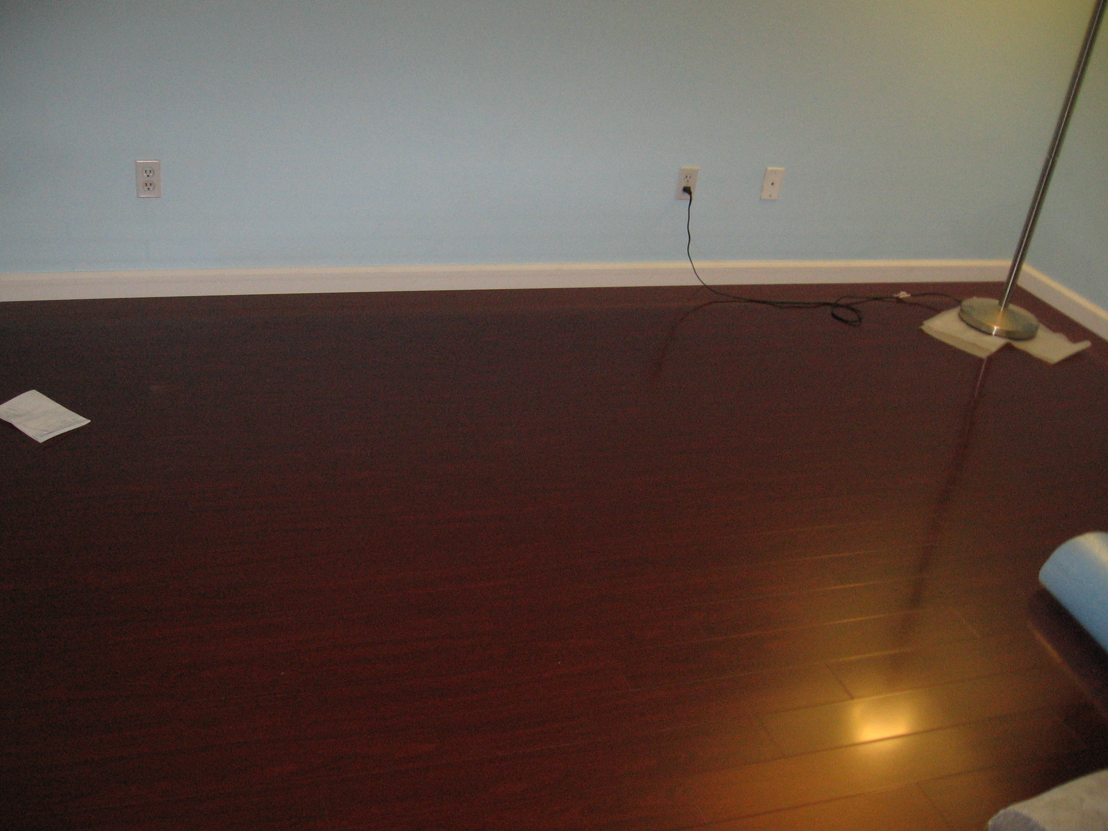

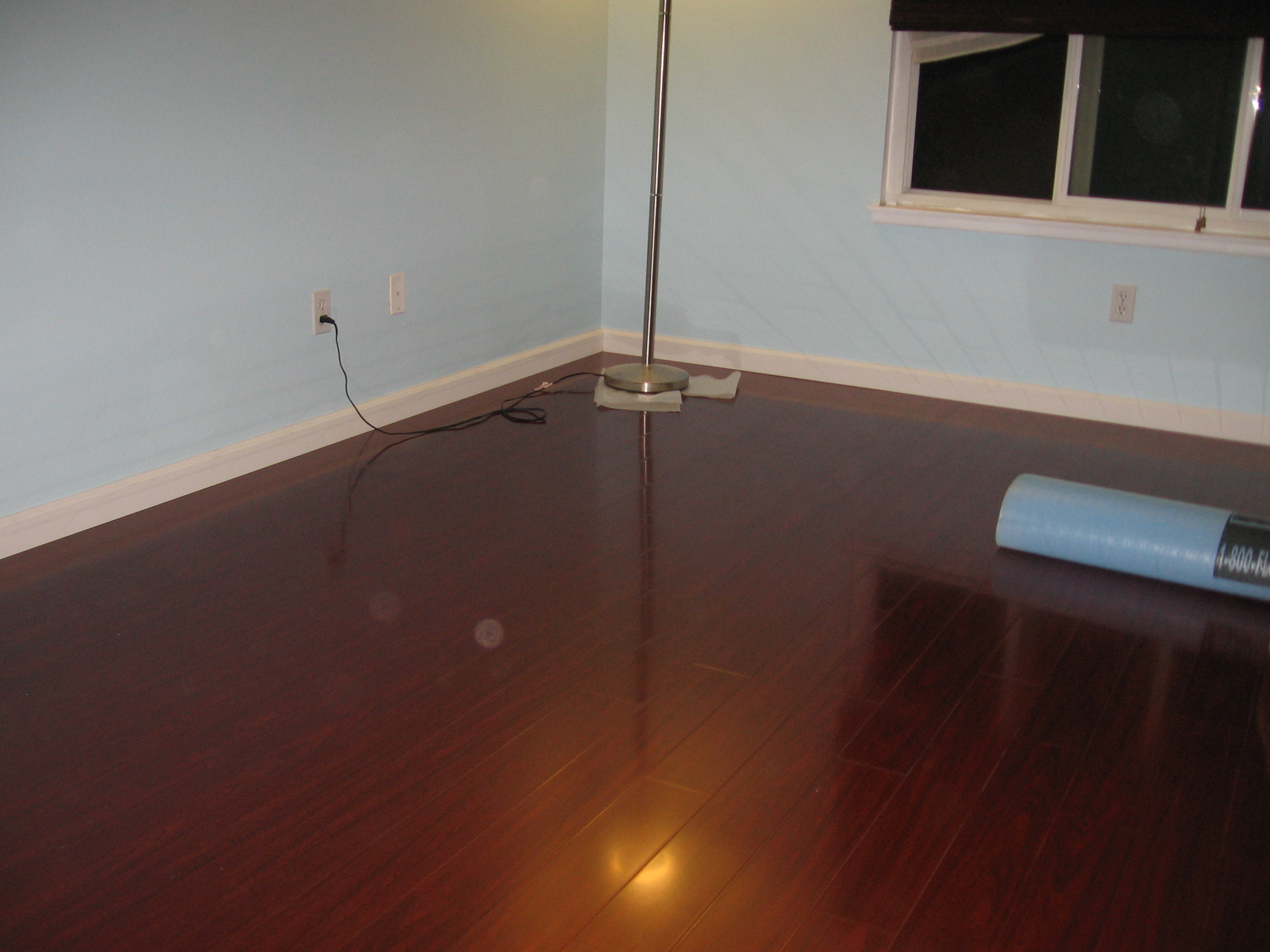

                  Thanks Justin, sorry I dont have access to the internet till today. Well, I did not have much time to do anything since I last posted. I'll see if I can get something going later today. There are so many things I have to do on the new house so all my schedules are backed up. My estimated completed time is off and it looks like I'm doing everything in the house. Dont believe what your Fiance said... you're ended up doing everything hehehe She started to paint one door and got tired hahahaha... So it looks like I'm doing the painting on the house too Anyway, I just took 2 pictures at night time of the completed room.
                  Thanks all for the help. I might have more questions later down the road
                  Al,
                  • Shep
                    • Nov 2008
                    • 710
                    • Columbus, OH
                    • Hitachi C10FL
                    #24
                    Looks great!

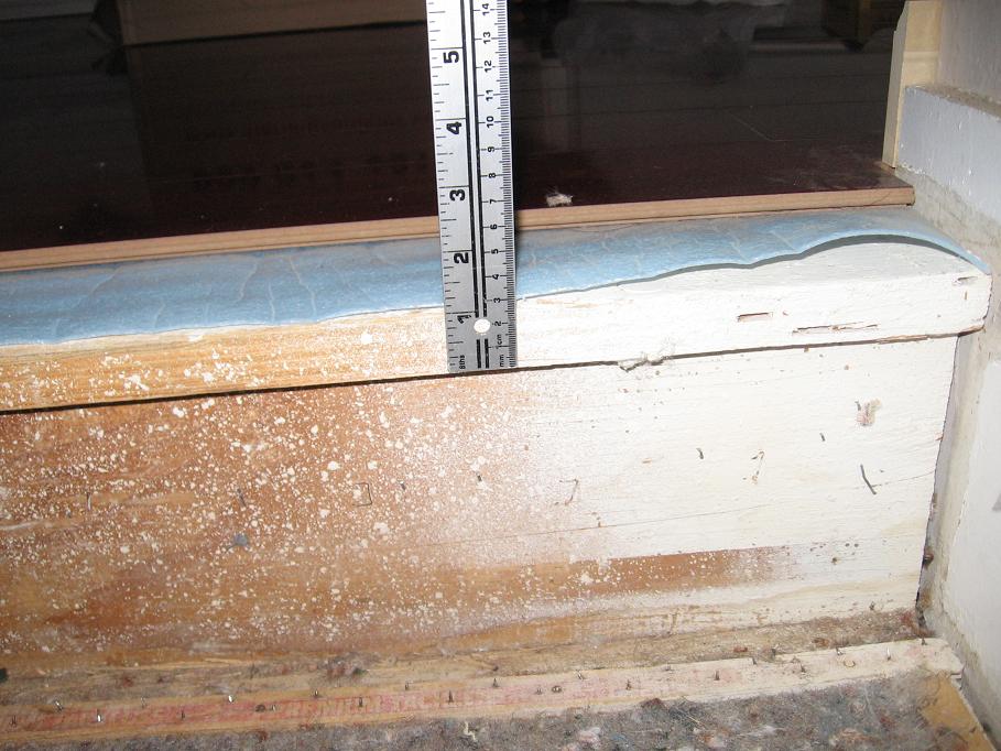

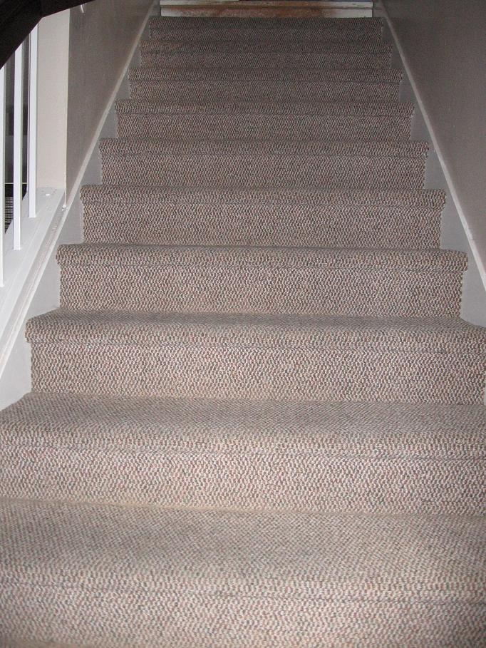

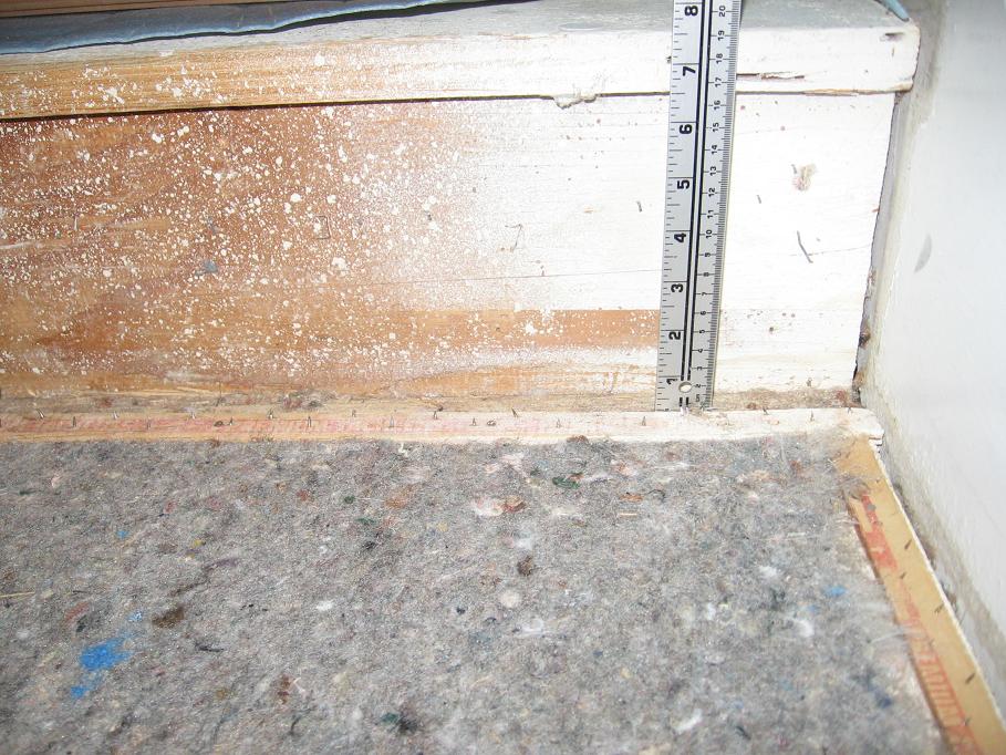

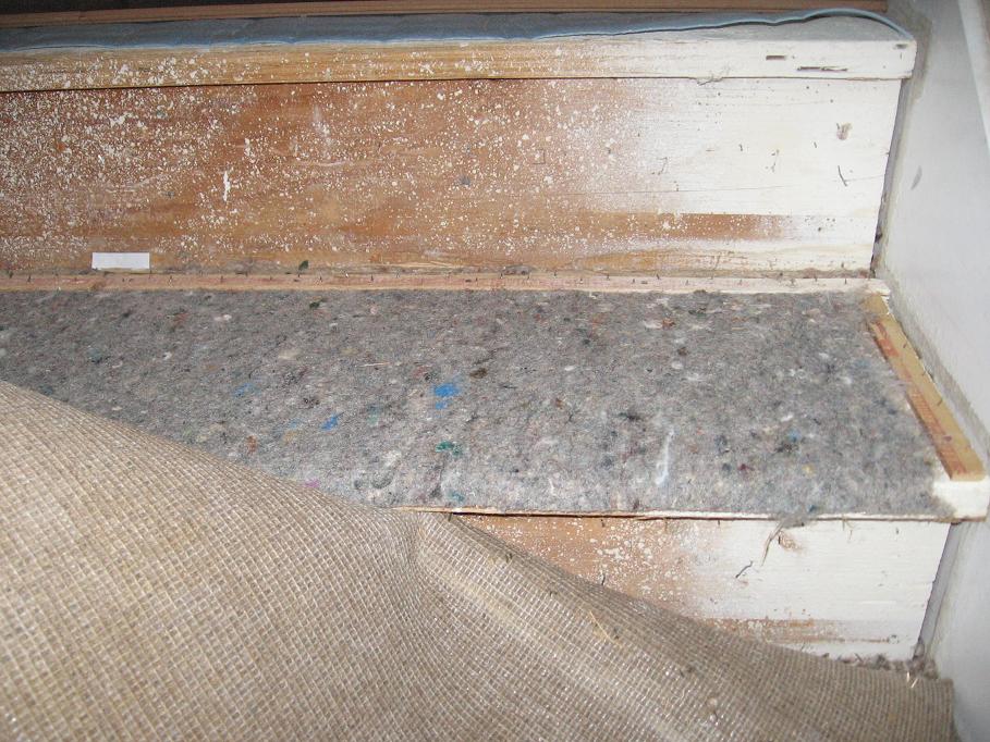

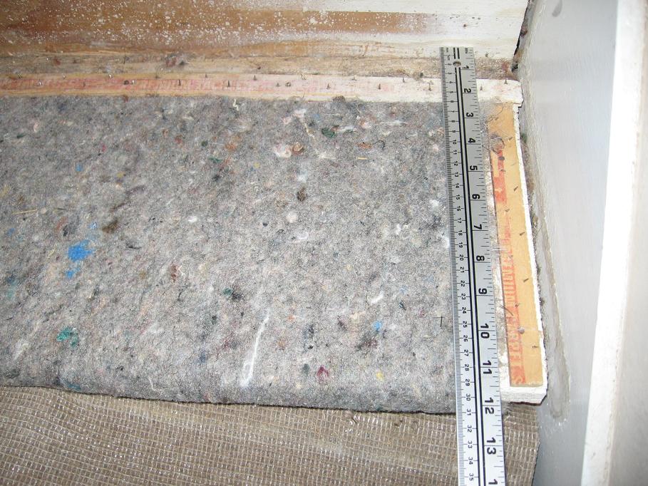

                      I've completed the whole second floor a few weeks ago, but I did not have much time for an update up here. Anyway, I'm going to need you guys help on the stair. I'm going to stay with the same laminate for the stairs. There are 14 steps and they are all straight no curve or anything like that. My stairs have about 1 inch sticking out on the steps. They are not perfectly square. The question is should I cut that off and make the stairs all square up? Also, on the laminate wood stairs do I use glue to glue down all the woods? Do I glue down the riser pieces too or nail the risers is acceptable?
                      Sorry, I have no pictures at the moment.
                      Thanks all.
                      Al,
                        #26
                        You are covering both the treads and risers on the stairs with laminate? I think I would just leave the existing treads if they aren't in terrible shape. Can you take a picture of the stairs? My recommendation will change depending on what they look like. I would not cut off the overhang on the treads. If you do, your tread will not be wide enough. Squaring them up in place will be tough without removing them anyway. I would just cut the laminate to fit. Post a picture of the stairs and we can help a little better.
                        • Mr__Bill
                          • 2096
                          • Tacoma, WA
                          #27
                          I have to agree with David, if you cut the nose off of the tread they will be hard to walk on and most likely no longer meet code.
                          If the staircase was built such that you can pry the tread off without destroying the whole thing, then you can replace the treads. Rather than covering them with laminate I would stain and finish some hardwood to look like the laminate and use that as the replacement tread. You really do want that 1" overhang and a rounded nose on the tread, both for looks and walkability.
                          If replacing is not an option and you have to cover them, then you will have to cut the nose off and replace it with a hardwood piece that is rounded over (bullnose not half-round) and coves the leading edge of the laminate. It is tempting to nail this on but your better off with screws and wood plugs then finish in place.
                          Yes, glue both the tread cover and riser cover on. Nails in the laminate will make it look tacky.
                            #28
                            You probably still need the nosing in order to meet code. I don't know what covers your jurisdiction but there is an exception in the 2003 IRC (International Residential Code) that doesn't require a nosing if the tread depth is at least 11 inches. I'll quote the section below.
                            If you loose the nosing and do the laminate you'll still need to figure out how to finish the corner where the riser and tread meet. We did a 3" wide hardwood bullnose piece in a recent condo project where we finished the stairs with the same maple flooring material that we did in the units. You might be able to get some prefinished nosing strips that match your new laminate from your flooring distributor.

                              Thanks guys. The steps are about 7.5" in height, 11.5" width with the nose). There are 14 steps straight up. Right now, I still have the carpet covering them.
                              Here are the pictures. I've also included two pictures of my completed floor (lil messy... I still haven't unpack all my boxes from moving ).
                              Thanks.
                              Al,
                                #30
                                I agree w/ Cabinetman, I'd leave the steps carpeting. 2nd to bathrooms, most of the accidents that occur in a house are on stairs. Stocking feet and laminate stairs is a recipe for disaster.
