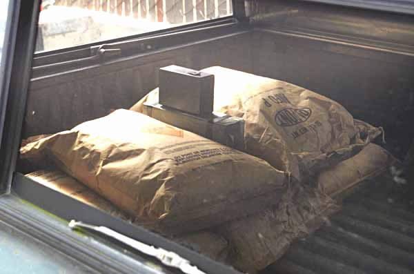

                  This will get 'er done. Albeit noisy.

                          I'd like to keep the house.
