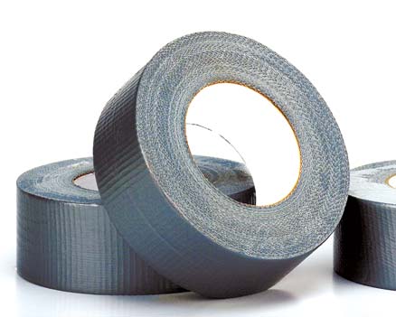

                  Handyman's secret weapon! Perfect for this job and has a host of other uses!
