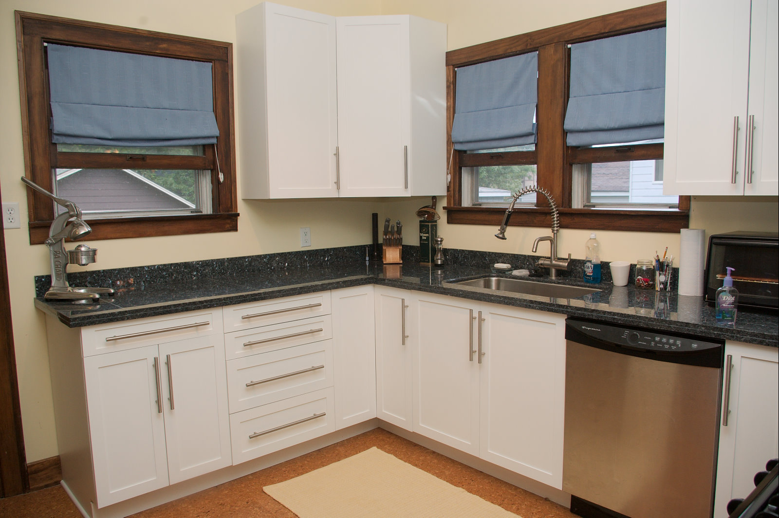

                              About two years ago, I installed a modular granite DIY countertop when I remodelled the kitchen in my previous house. The system was really pretty easy, and I was very pleased with the results. I got the pre-cut pieces from Artisan Granite, including the undermount sink, for around $1400 delivered (from Rhode Island to Chicago). I was very pleased with the support and instructions included, too. Any questions I had were promptly answered with a quick phone call. The only problem with DIY granite like this, or other tile systems, is you do have noticeable seams. The epoxy I used for the joints blended pretty well visually, but it wasn't what I'd call invisible. If you look at the attached photo, you can see some of the seams. But since the "tiles" were so large, there were only five or six seams. The house sold very quickly a couple months ago, so it must've been a good enough job!
                              That said, I've moved into a new (old) house and planning yet another kitchen remodel, and this time I'm looking at soapstone, because that's what SWMBO wants. I'm looking at getting the DIY slabs from M. Teixeira. There are lots of good videos of installation techniques here.
