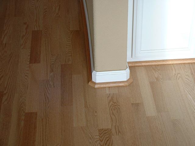

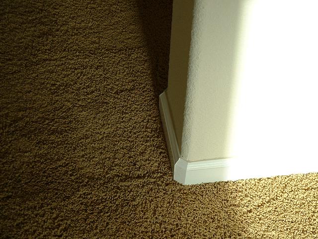

                            This is how the model homes by my house did it:
                              Depending on how small the radius is, you could do it with angle cuts, but you'll still have flats showing. If you want to have a curved base, that can be done easily with a bent lamination to a form you make from a template. Sounds like overkill for a small piece or section, but once in place, it looks like the house was built around it. If you want a quick solution there are flexible mouldings that you can buy that work well. Some of those little details can take up as much or more time for a run in a room than all the rest of the room. Part of the decision making might be if it is to be finished woodwork, or painted, and how much you want to involve yourself in the project.
