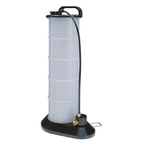

                          This one works, no electricity.
                          I have this vacuum and it works great for changing the oil on small engines.
                          http://www.amazon.com/gp/product/B000JFN9WW
                          Jamie

                            Harbor freight sell a 2 1/2 gal vacuum tank for changing oil. Try 45403-3vga IIRW its about $ 25, ita a new item in the store
