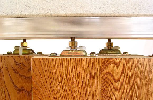

                    Cab,
                    Tequila described the way they attach. This picture shows it a little better.
                    It is really easy to take the doors off if you want to. In fact, I intend to take them off when we re-paint the room. The adjustment is a bonus. You can level each door, or, as I had to, lift the doors off the carpet.
