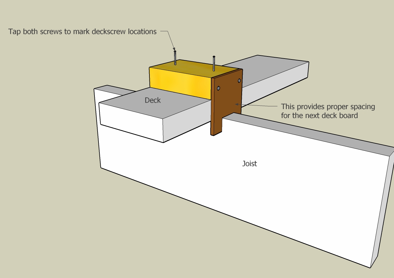

        Since I wanted a neat appearance with the exposed screws, I made a simple little jig out of a scrap of 2x4 cut the same length as the width of my deck boards. I screwed a piece of 1/4" hardboard to the end, with a slot cut into to match the width of the deck joists. I also drove a couple of deck screws at the desired spacing into the top of the 2x4, just far enough that the tips barely poked through the bottom.
        Set the deck board in place, slide the jig over the joist and deck board.
        Tap the top of the jig to mark the screw locations.
        The 1/4" hardboard provides spacing for the next board.
        I made two of these since my dad was helping me. I was happy with the way it ended up. All the screws were neatly lined up and the same distance from the edge of each board, and it didn't add much time to the process.

                          That's a pretty slick spacer. When I did my deck and my daughters, just pounded a 16 p nail in a short block of 2 x 4 (did 4 blocks) and used them for the spacing between the boards. If the wood is still quite wet, you may want to use a 8 p or even a finish nail, as the spacing will shrink as it dries and the spacing will become larger.
