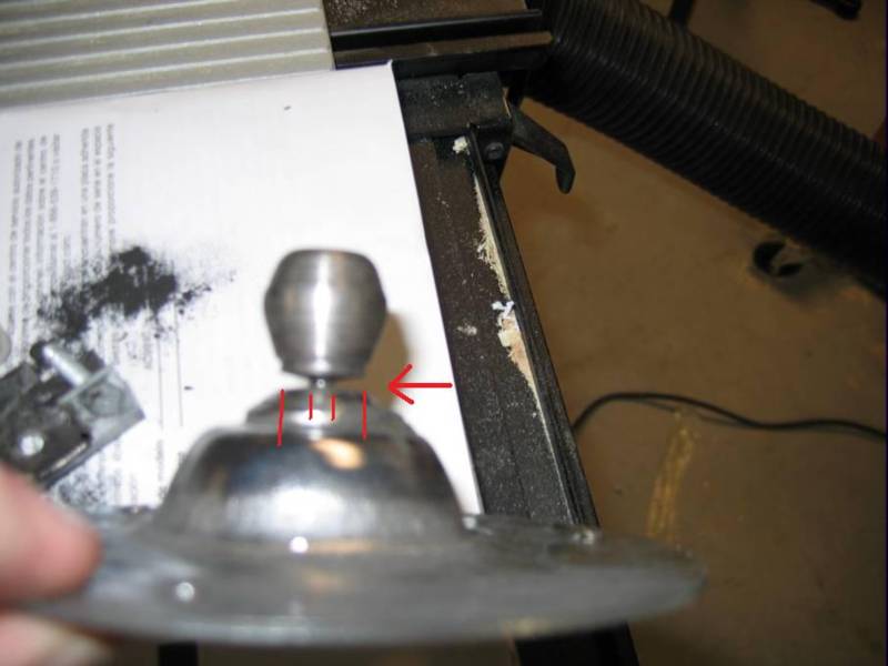

            And the picture as promised...
            This is not a great photo I know, but if you look at the base of the "ball" there's not supposed to be a tiny neck there, but a much thicker chunk of metal indicated by the red lines. Additionally the "ball" was a sphere on the new one but ground way down on this one. I was able to snap that off easily with my bare hands... Had that happened while running I imagine it would not have been a $22 fix...
