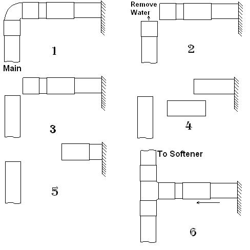

I need to tap into the main water line for a softener. Between one elbow and the house wall I have about 4.5" to work with. The problem is that between the elbow and the wall (about 5/8" from the elbow) there's a coupling already in place. I don't really want to touch the elbow as it is too close to the main shut off.
My question is, if I were to try removing the coupling, since it is so close to the elbow, I think the exiting elbow joint maybe loosen. If I were to cut it at the edge of the coupling, I have only less than 1/2" overlap for the soldering, would it be enough?
