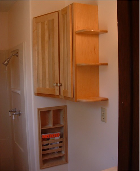

    After putting it on the back burner for almost 2 years, I finally got the cabinets installed in the Master Bathroom. Construction is Maple/Birch ply with Maple stock for the facings, doors, and drawer fronts. Drawers are constructed of 1/2" Baltic Birch ply. Finish is high gloss precatylized laquer.
    The magazine rack/shelves are to fill a hole cut to allow access to the plumbing between the shower and bathtub. The cabinet doors were edge glued and the joints accented with a shallow 'V' groove on the router table.

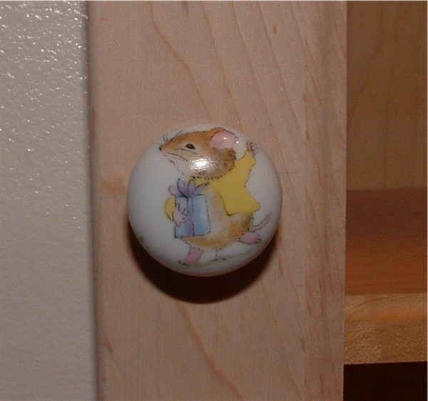

    The knobs were special ordered for the 'Boss' and her collection of mice.

    Looks good. Nice clean style.

      Nice job. Ceramic tile is fun, you have to make sure everything is perfectly level and void free.

          Ummm, I see some very nice custom cabinetry, but I CAN'T see the light

            Nice Pappy! I like the Wood Mag sitting in the rack. Wood mag should do a project that is a magazine rack/toilet paper dispencer. I think it would be a popular project. That's were I keep my recent copies anyway.

                    Those knobs are fun. And I like the angle-design on the wall cabinet, makes it very clear that this is custom work. Good luck on the tiling!

                        That looks great Pappy and also a good idea on the magazine rack.

                          Great job Pappy. Love the mouse accents. Two years ain't bad, it took longer than that to decide what we were going to do to referbish the kitchen at our last home. And it only took three weeks to do it.
