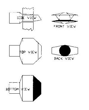

              My neighbor had this very problem. He fashioned a single brick-sized box from narrow-gauge steel, with a 4" round stub on the inside, and a sloped hood on the outside. Then he just mudded it in.
              Here's a quick sketch... Seems like a lot of work to me, but he's good with metal, and it looks great.
                I think the first reply was the best idea. A light duty hammer drill will go through brick like a normal drill goes through wood - or easier. A long masonary bit - as long as the wall is thick - will let you cut a hole by drilling a whole series of smaller holes. The flange around the dryer vent will cover the ragged hole edges. You can also take a few bricks out and then cut them, mix up mortar, and put them back to make the hole but that is more work. Either way is easier than making some special metal piece.
